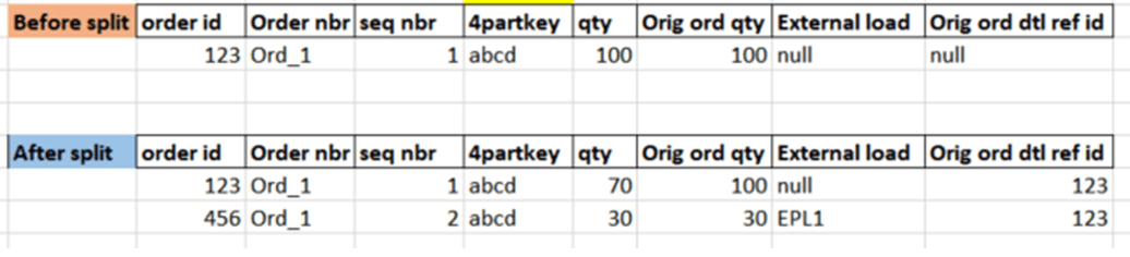

Note: During Transportation Split, the only reference to find the new Order details created from the source order detail is from the Order detail reference number field. The Order Detail Original Sequence Number field is available (in all file formats) to be shared via the WOA output interface (WAVE PICK INFO), SLS Output Interface, OBLPN Shipping info Output interface, and Pallet Shipping info Output interface.Original Sequence Number Field

  • As you are splitting the Order Detail, every time the system creates a new sequence number. So, the unique identifier here is the 4-part key (erp_source_hdr_ref + erp_source_line_ref + erp_source_shipment_ref + erp_fulfillment_line_ref).
For example, consider an order ORD-01 requires 100 quantities of SKU-1.
Order Before Planning:
Order Number SKU Ordered Quantity External Planned Load Number
ORD-01 SKU-1 100
If you plan LOAD-1 and LOAD-2 with 50 and 20 quantities respectively via Planned OB Load Interface, the system splits the 100 quantities of ORD-01 order detail and updates the order details as follows.
ORD-01 SKU-1 30
ORD-01 SKU-1 50 LOAD-1
ORD-01 SKU-1 20 LOAD-2
