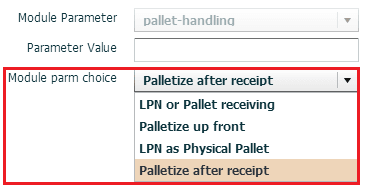

Configuration for Palletization during Receipt
For receiving flows with palletization, the receiving module must be configured appropriately. There are four types of palletization during receipt:
  • LPN or Pallet level receiving
  • Palletize up front (before scanning LPN)
  • Palletize at end (after scanning LPN)
  • Receive LPN as physical pallet (the LPN is treated as a pallet in the system)
To Configure on the UI
  1. Go to the “Screen Configuration” screen.
  2. Select the receiving module (rf.inbound.cwrfrecvlpnshpmt) click on Details ().
  3. This will open a window with all the module’s parameters. Select parameter pallet-handling and click Edit ().
  4. Click on the “Module parm choice” drop-down menu and select the appropriate palletization mode.
    Module parm choice
