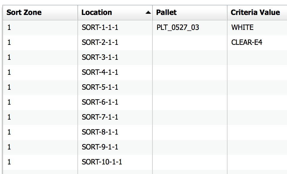

Select this newly created Sort Zone record and click on its details via the details button. This will open a new window, which displays the Location, Pallet and Criteria Value (Area, Aisle, Allocation Zone, Location Size-Type):
Sort Zone Details
The Location column displays the Sort Locations that are configured for the Sort Zone. In the figure above, there are 10 sort locations configured for Sort Zone 1.
The Pallet column displays the current active pallet per the Sort Location. A pallet is considered ‘active’ when there is an open pallet with merchandise located at the Sort Location. There are a few points to consider when scanning a pallet to a Sort Location:
  1. There may only be one active pallet in a Sort Location at a time. This active pallet is populated in the “Pallet” column.
  2. When the pallet is closed (via the Ctrl-E option in the Mobile Transaction), the pallet value will disappear from the Pallet column, but its Criteria Value will remain.
    1. For example, in the figure above, location SORT-2 has no pallets but is assigned to criteria “CLEAR-E4”. This means that the next CLEAR-E4 item scanned is directed to this location, but the user will have to scan a new pallet.
  3. The Criteria Value is only cleared when all pallets for that criteria (Putaway Type) have been located out of the Sort Location.

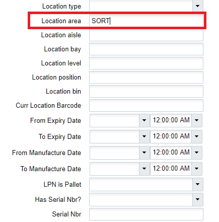

    1. Users can search for pallets located in specific Sort Locations via the magnifying glass button in the “IB LPNs” screen:
      Search for Pallets
  4. When an LPN (Serial Number) is scanned into a pallet, it will change to “Allocated” status. Its status will only reset to “Located” when its pallet is closed. This means that a pallet or LPN cannot be moved until its pallet is closed. The user can validate this by searching for the LPN and verifying its status and location via the “IBLPN” screen.
