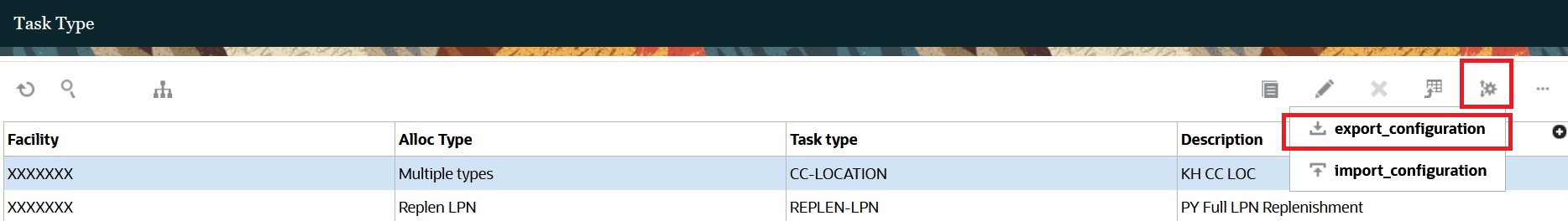

To export the configuration, do the following:
  1. Go to your preferred UI or screen that supports config action button (applicable UIs or screens mentioned in the above list).
  2. Select the records to export.
    • If you are not selecting any records, the system exports all data available on the screen.
    • Searching for a few rows and then exporting without selecting any record will still export all data (regardless of what was searched).
  3. On the right corner of the UI’s table, click “config” action button.
  4. In the drop-down options, click “export_configuration” option.
    Export Configuration
    The system prompts to save the configuration file (.cfg file format) that needs to be downloaded in the local file system.
    Note: You have to enable download permissions on your browser to download and save the export configuration file.
  5. Select the folder location and click Save.
Note: The downloaded configuration file is an encrypted text file. So, any attempt to modify the file corrupts and render it as un-importable.

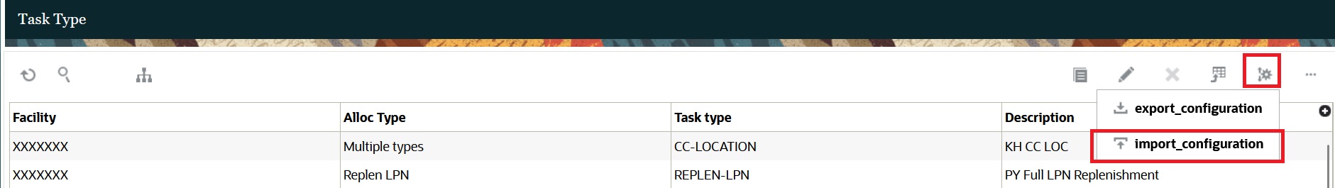

To import the configuration, do the following:
  1. Go to the UI or screen that supports config action button (applicable UIs or screens mentioned in the above list).
  2. On the right corner of the UI’s table, click “config” action button.
  3. In the drop-down options, click “import_configuration” option.Import Configuration
  4. On the dialog box screen, click “Choose Files” button.
  5. Then, select the previously exported configuration file and click Upload.
