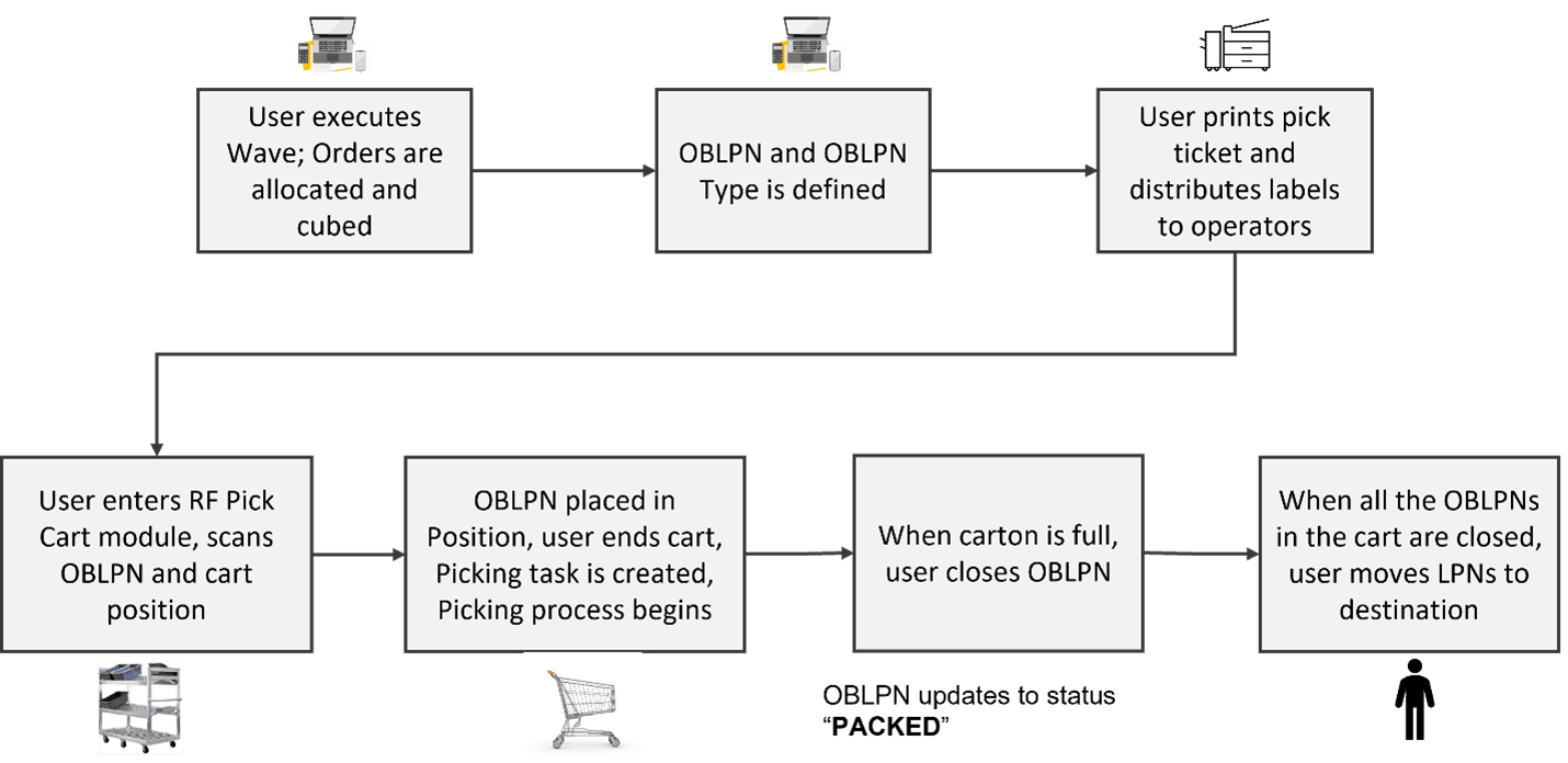

Pick Cart is a form of batch picking where you use a cart to pick and pack multiple orders on a single trip through the warehouse. A generic Pick Cart process in WMS is displayed below:
Pick Cart
Pick Cart enables pick multiple orders concurrently into the final shipping container. The pick cart transaction might only be used to pick orders which are cubed into OBLPNs during the waving process. As OBLPNs barcodes are scanned onto the pick cart, the WMS automatically creates picking tasks. These tasks are then executed by warehouse employees who build the pick cart.

Creating Pick Cart Tasks
You can create pick cart tasks using the following steps:
  1. Prior to picking process, scan a pick cart to begin assigning OBLPNs to a Pick Cart task.
  2. Upon scanning each OBLPN during picking, the system will assign a Position Number to the cart that helps you in directing a product to the correct OBLPN.
  3. Press CTRL+E to close the Pick Cart (or you can scan until you reach the maximum allowed OBLPNs). This will create a Pick Cart task.
    Note: The Task Details will be sequenced by Location Pick Sequence.

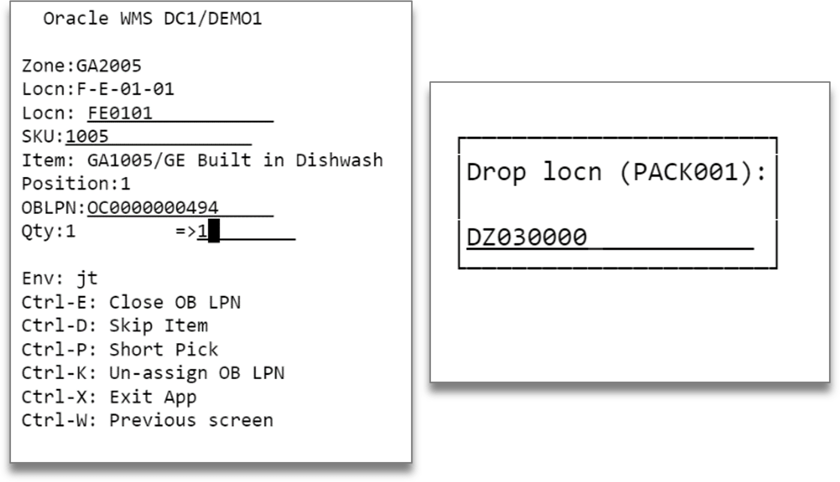

    Pick Cart Task
Executing Pick Cart Tasks
  1. Picks are executed on the task based on Location Pick Sequence.
  2. You will be prompted for Location, Item, and Quantity based on screen parameters you configure.
    On the LPN/SKU/Quantity scan screen, you can use the “Ctrl-V: View Details” hotkey to view the following allocated inventory details for the scanned SKU.
    • Item Barcode
    • Item Description
    • Quantity to Pick (Allocation UOM)
    • Lot/ Batch Number (if available)
    • Expiry Date (if available)
    • Inventory Attributes (a to o, if available)
    The “Qty to Pick” field displays the remaining allocated quantity to be picked.
    • If a SKU has a single allocation, the details will be displayed directly.
    • If a SKU has multiple allocations for the same LPN with different attributes, expiry, or lot/batch, the system displays separate allocations with a line, omitting common fields to avoid repetition.
  3. You can confirm picks by scanning the OBLPN barcode or the Position Number based on screen parameters.
  4. After all picks are complete, you can locate the Pick Cart and all OBLPNs to a drop zone location, if necessary.
    Execute Pick Cart
  5. Upon completion, the task Status is updated to Completed.

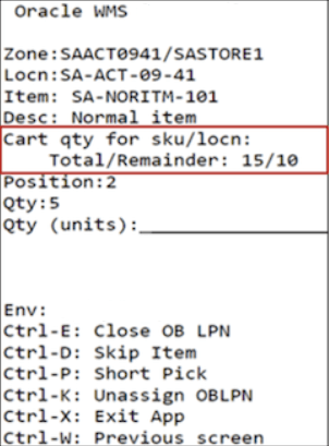

Displaying Total Quantity in Mobile Pick Cart
The “Show-total-qty-info-for-location-SKU” parameter displays the total units that are picked from a location for your whole cart.
After configuring this parameter, you can save time especially in scenarios where you can pick multiple quantities at a time and distribute them across all the bins in your cart. Knowing the total quantity of items to be picked from a location reduces your movements during picking and this improves your productivity.
Also, knowing the total number of units needed to be placed in the cart improves productivity and speed because the system displays the total units picked and the number of units expected to be placed in each bin.
For example:
Let’s say, you built a pick cart with multiple containers on your pick cart, and the total to be picked from the location/SKU is 15 units. All 3 orders require 5 units of USB cables.
To enable the show-total-qty-info-for-location-sku parameter:
  1. Navigate to the Pick Cart Module > Screen Parameter.
  2. Select show-total-qty-info-for-location-sku > set the parameter choice to Yes.
  3. Click Save.
  4. After configuring the parameter, run the RF Pick Cart transaction. The Pick Cart screen displays the total quantity to be picked from the location all at once.
    “Total” indicates the total number of units to be picked from a location and “Remainder” indicates how many units are pending to be placed in the bins on the pick cart. To begin with, both these numbers are the same and you are prompted to place 5 units in Position 1. After you place 5 units in position 1 and confirm, “Remainder” is reduced by 5 units, and you are prompted to place 5 units in Position 2.
    Display Total Quantity
  5. The transaction continues until you place all of the units in different positions of the cart as directed by the RF screen. That is, you can walk to the location only once to pick the total units and you place the units in different positions as directed by RF Pick Cart.

  1. Start the Pick Cart transaction.
  2. Scan or enter the item.
  3. If configured, scan the requested batch, expiry, or inventory attribute values.
  4. Review the quantity prompt. WMS shows the quantity for the selected inventory line.
  5. Scan or confirm the quantity.
  6. Continue the pick.
When prompting is enabled, WMS does not consolidate all item quantities into one prompt. It splits the pick by inventory line, so the user picks the correct batch, expiry, or attribute combination.
Prompt Behavior
When prompt-batch-expiry-attr is blank, WMS keeps the existing behavior and does not prompt for batch, expiry, or inventory attributes. When it is set to Always Prompt, WMS prompts after item scan in this sequence:
  1. Batch or expiry.
  2. Inventory attributes A to G.
  3. Quantity for the selected inventory line.
