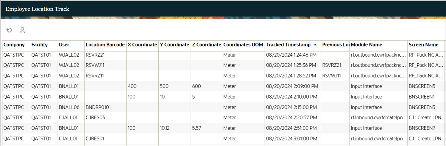

When a user scans a location while performing an activity using a WMS handheld screen such as Locate LPN, the location scanned along with the time at which the location was scanned, and other relevant information is written to Employee Location Track view.
Some of the key fields that are captured during location scan using WMS handheld is listed below:
  • User: Employee that scanned the location.
  • Location Barcode: Barcode of the location scanned by the employee.
  • Tracked Timestamp: Date and time at which the location was scanned.
  • Previous Location Barcode: Barcode of the previous location that was scanned by the user (if any).
  • Module Name: Module Name of the WMS handheld screen.
  • Screen Name: Name of the WMS Screen that the employee was using when location was tracked.
  • Equipment Type:An identifier representing the equipment (if any), that the employee was operatingwhen the location was scanned.
  • Task Nbr: Task, if the activity was being performed in tasking mode.
  • Task Type Exec Seq Nbr: Execution seq nbr of the task, if the activity was being performed in tasking mode.
  • IHT Group Nbr: Group Nbr of the Inventory History transaction if WMS has this information at the time the record is written.
  • IHT Sequence Nbr: Sequence Nbr of IHT Group, if WMS has this information at the time the record is written.
