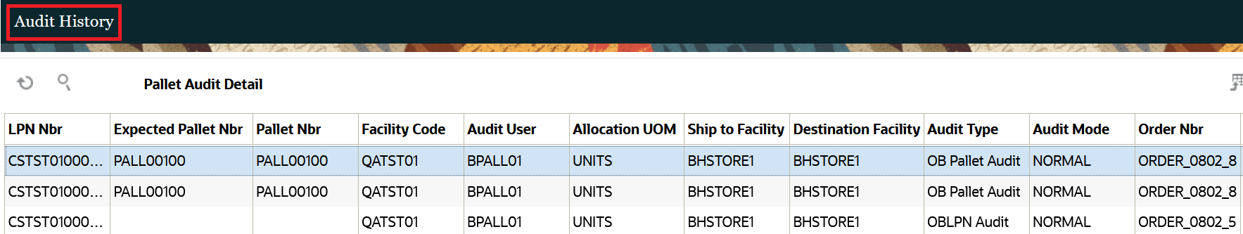

Audit History
The Audit History screen shows most of the detailed information for the audit so that you often do not need to go to the details screen to view details and discrepancies. The following screen shows what the Audit History screen looks like. Refer to the Audit Detail History Columns section below for more details.
Image of the Audit History screen
From the Audit History screen, you can click Pallet Audit Detail to view details such as expected and scanned number of LPNs, difference, number of expected LPNs scanned, and OBLPNs not anticipated.
Audit History Columns
Column Description
Pallet Number Pallet Number which has been scanned in Audit, If Pallet not Scanned display null
Audit OB LPN Number Outbound LPN which has undergone Audit
Load Number Load Number associated to the Pallet/OB LPN. If OB LPN is associated with Parcel carrier then display Load Number field blank
Expected Pallet Number When OB Pallet is scanned, this column depicts the pallet number associated with the OB LPN Scanned
Audit Mode Normal or Simulated
Audit Type OB LPN Audit or OB Pallet Audit
Item Code Item Scanned, If Outbound LPN scanned has multiple sku’s write different rows for each sku
Packed Qty Packed Qty associated to the inventory record for OB LPN. Qty Present on the OB LPN when the Outbound LPN was Packed.
Current Qty Qty present in OB LPN during Audit (Can be 0 if Sku scanned is not anticipated in the OB LPN Scanned
Audit Qty Quantity audited by User (Can be Zero or less or equal or greater than current qty)
Unit Variance Current Qty-Audit Qty (If Audit Qty is greater than Current Qty, display the value in brackets).
Total Pack Cost Unit_Cost for the item times the quantity expected for the sku in the OB LPN
Total Audit Cost Unit_Cost for the item times the quantity Audited for the sku
Cost Variance Total Pack Cost-Total Audit Cost. (If Total Audit Cost is greater than total pack cost, display the value in brackets).
Alternate Item Code An alternate representation of the SKU, which concentrates SKU parts A through F into a single record.
Audit User User who performed the audit transaction
Item Description Description of the item.
Destination Facility Code Destination facility for the OB LPN Scanned in Audit
Ship to Facility Code Ship to facility for the OB LPN Scanned in Audit
Allocation UOM Units/Packs/Cases
Pack Qty Item’s Standard Pack Qty
Standard Case Qty Standard Case qty from item
Pick User Pick user associated to the Outbound LPN
Pack User Person who Packed the Outbound LPN.
Audit _ts Create time stamp of when Audit Performed
Packed_ts Time Stamp of when the Outbound LPN was packed
Manifest Number If Outbound LPN is not associated to load, display manifest number, if associated to Manifest
Order Number Order Number associated to the OB LPN
Order Type Order Types differentiate orders based on certain characteristics.
OB LPN Type Container Type associated with the Outbound LPN Audited
Allocation Type Allocation Type from the Corresponding Allocation Record associated with the Outbound LPN
Batch Number Batch Number for the Item Associated with the Outbound LPN Audited.
Item Hierarchy Code Describes the item hierarchy.
priority_date Priority Date of the item associated with the Outbound LPN Audited.
invn_attr_a to invn_attr_o Inventory attributes of the item associated with the Outbound LPN Audited.
exp_date Expiry Date of the item associated with the Outbound LPN Audited.
facility_code Facility Code of the item associated with the Outbound LPN Audited.
wave_nbr Refers to a grouping or batch of orders that are processed together as part of a single wave.
mod_user User ID of the user who executed the Outbound LPN Audit.
alloc_mod_user User ID of the user who executed the Outbound LPN Allocation.
discrepancy Yes/No. Denotes if there is a difference in the current quantity and audited quantity.
reason_code Records the reason code mentioned during the audit.
