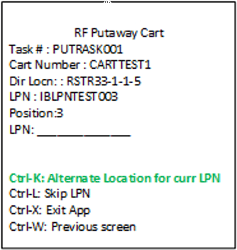

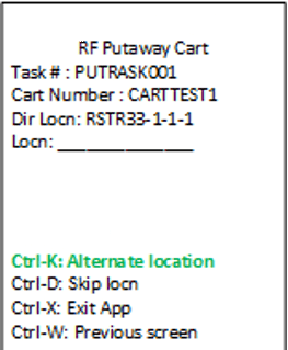

Note: In the Putaway cart flow, the Ctrl-K hotkey is used for updating locations.
Ctrl-K hotkey
The "Ctrl-K: Alternate Location" option appears in the Location prompt, while the "Ctrl-K: Alternate Location for current LPN" option is available in the LPN/Position prompt.
The latter is specifically used to update the location only for the prompted LPN when it cannot fit within the designated space. Upon pressing Ctrl-K, the system will perform a Reason Code Selection Check as outlined.
