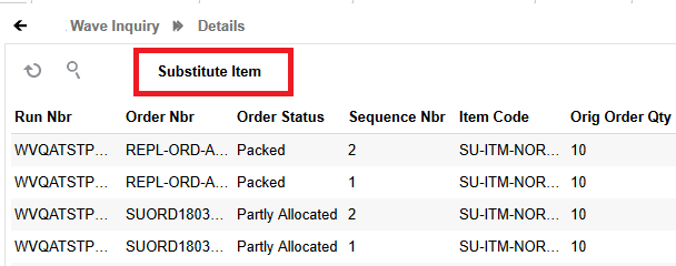

Substitute Item
You can change or substitute an item on the order detail for an order. If there are no sufficient items available and if an alternative item exists instead of the originally allocated item to satisfy the order, you can manually substitute the item via the Substitute Item button on the Wave Inquiry UI. That is, the order will now have the item on the order detail, and the original item will be saved in the orig_item_code field, so that you can keep track of the original item ordered.
For example, you have an order = 10 Black pens. You are running short of 10 black pens to meet the order, but you have an alternative of blue pens in your inventory. Given, your customers have agreed to receive blue pens instead of black pens, you can substitute the order details via the Substitute item button. After substituting, you need to run the wave in order for the system to allocate the inventory.
Note: This button is permission enabled. You need to be associated to a group where the permission is enabled to perform this operation. The permission needed for Substitute Item is substitute_item_in_orders.
Substitute Item
To substitute an item in the order details, the allocation run for the order detail must have 0 in the allocated quantity.
  1. Go to Wave Inquiry > and Select the Order from the Order header.
  2. Click the Details icon. The Order Details screen opens.

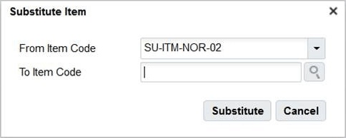

  3. Click the Substitution item button. The substitution Item window opens.
  4. Select the item from the From Item Code drop-down menu to substitute the item.
    Substitute Item
  5. Enter or search the item code in the To Item Code field to substitute the item with.
  6. Click Substitute button. On success, the item gets substituted on the order detail and order header level.
