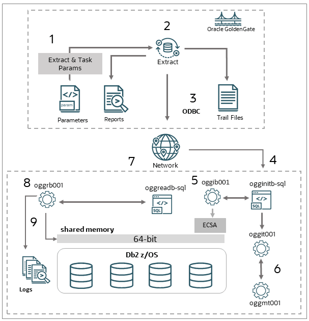

The Replication Process for Db2 z/OS Extract figure illustrates the replication process for the Db2 z/OS Extract and its mainframe components.
Figure 1: Replication Process for Db2 z/OS Extract
Description of image follows
The process starts and runs as shown in the figure ablve, using the numbers 1 through
  1. These steps are listed below: 1. Extract reads the parameters, including the JCL parameters, from the parameter file created during installation.
  2. Extract reports the startup information and prepares to write the trail files.
  3. ODBC is used to gather information from the Db2 database and start replication.
  4. The OGGINITB SQL stored procedure starts to prepare the shared memory and to gather other data needed for replication.
  5. The OGGIB001 external program called by the SQL stored procedure starts the memory monitor task using the OGGJT001 job setup program.
  6. The OGGMT001 memory monitor task starts monitoring the ECSA and 64-bit shared memory.
  7. The OGGREADB SQL Function calls the external program OGGRB001.
  8. The OGGRB001 external program repeatedly calls the Db2 log read program to create a result set that returns 1 to many log record buffers to the Extract.
  9. When a log record result set is complete, OGGRB001 ends after sending the result set to the Extract.
Extract repeats steps 7 to 9 until shut down or abnormal termination. If the memory task fails to start, OGGIB001 program returns a flag indicating there was a JCL error or setup issue and Extract begins to manage its memory. If the memory task starts properly, the memory task tests constantly changing fields in the 48-byte ECSA shared memory. These fields stop changing if the Extract terminates for any reason. At that point, the memory manager waits in case the Extract or network is slow and releases the memory before shutting down after a configured time limit.
