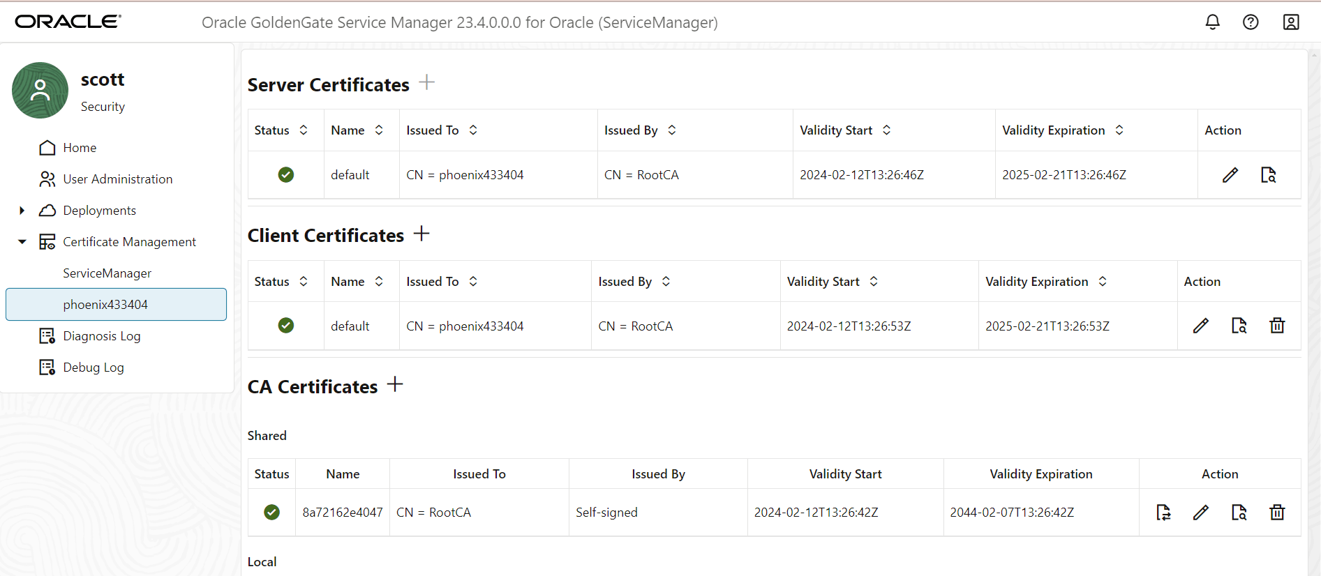

  1. Log in to the Service Manager.
  2. Select Certificate Management from the left navigation pane of the Service Manager home page.
  3. Select the deployment from the drop-down list to view information about the server, client, and CA certificates. The validity period (expiration date) of the certificate along with the used signing algorithms from the issuer are displayed. You can also view the certificates available with the Service Manager by selecting Service Manager from the Certificate Management sub-menu in the left navigation pane.
    Access certificate details by clicking the Details icon for the certificate.

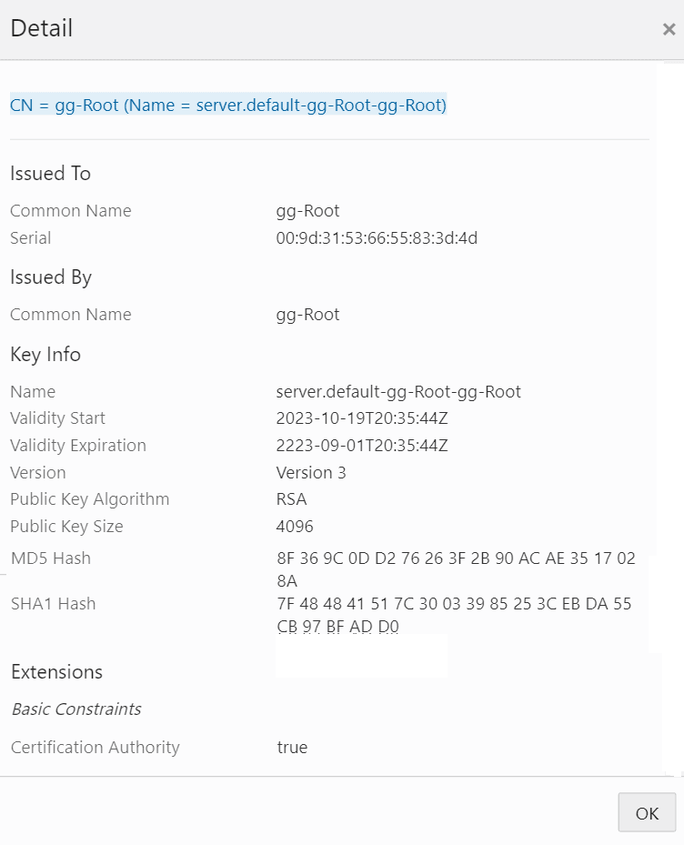

  4. To view further details about a certificate, click the Details icon from the Action column. The certificate details are displayed, shown in the following image:
    Certificate Details box
