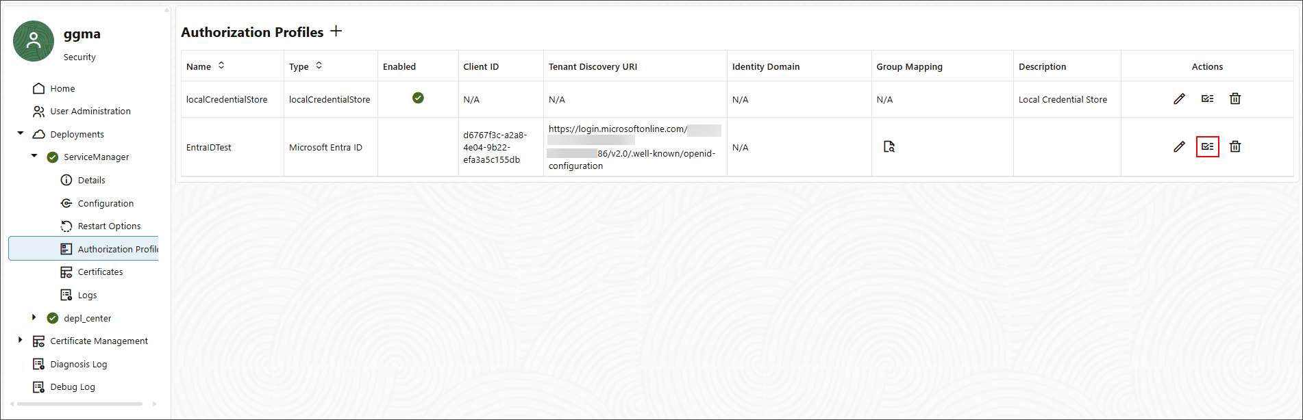

The following steps enable you to validate your authorization profile and enable it: 1. Log in to Service Manager and navigate to the Authorization Profile page. The Microsoft EntraID authorization profile is listed on this page.
![Authorization Profile page in Service Manager displays the EntraID authorization profile.](images/entraid_validateauthprofile.png " ")

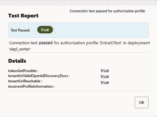

  1. Click the Validate profile icon. After the profile is validated, you will see a dialog box similar to the following:
    Authorization Profile validation passed.

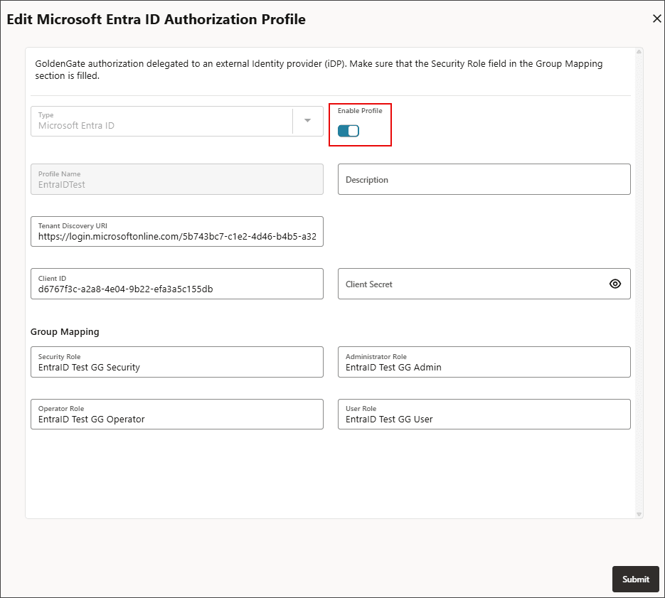

  2. Click the pencil icon in the Action column of the authorization profile and select Enable the authorization profile.
    Using the toggle switch to enable the authorization profile after successful validation.

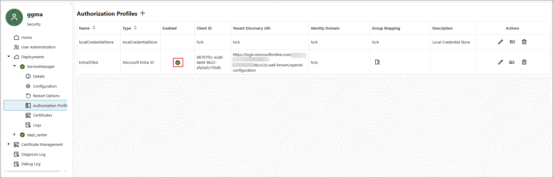

    The Enabled column displays the status of the authorization profile.
    Enabled authorization profiled
