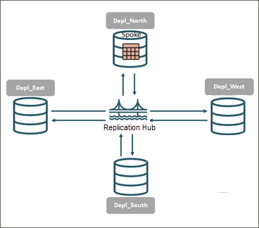

In a hub and spoke model, each read-write database is a spoke, and sends data to the hub, the hub then sends data to all the other spokes. The hub-and-spoke model works better for large number of deployments, but due to the extra hop at the hub, the latency is higher which can cause additional conflicts.
