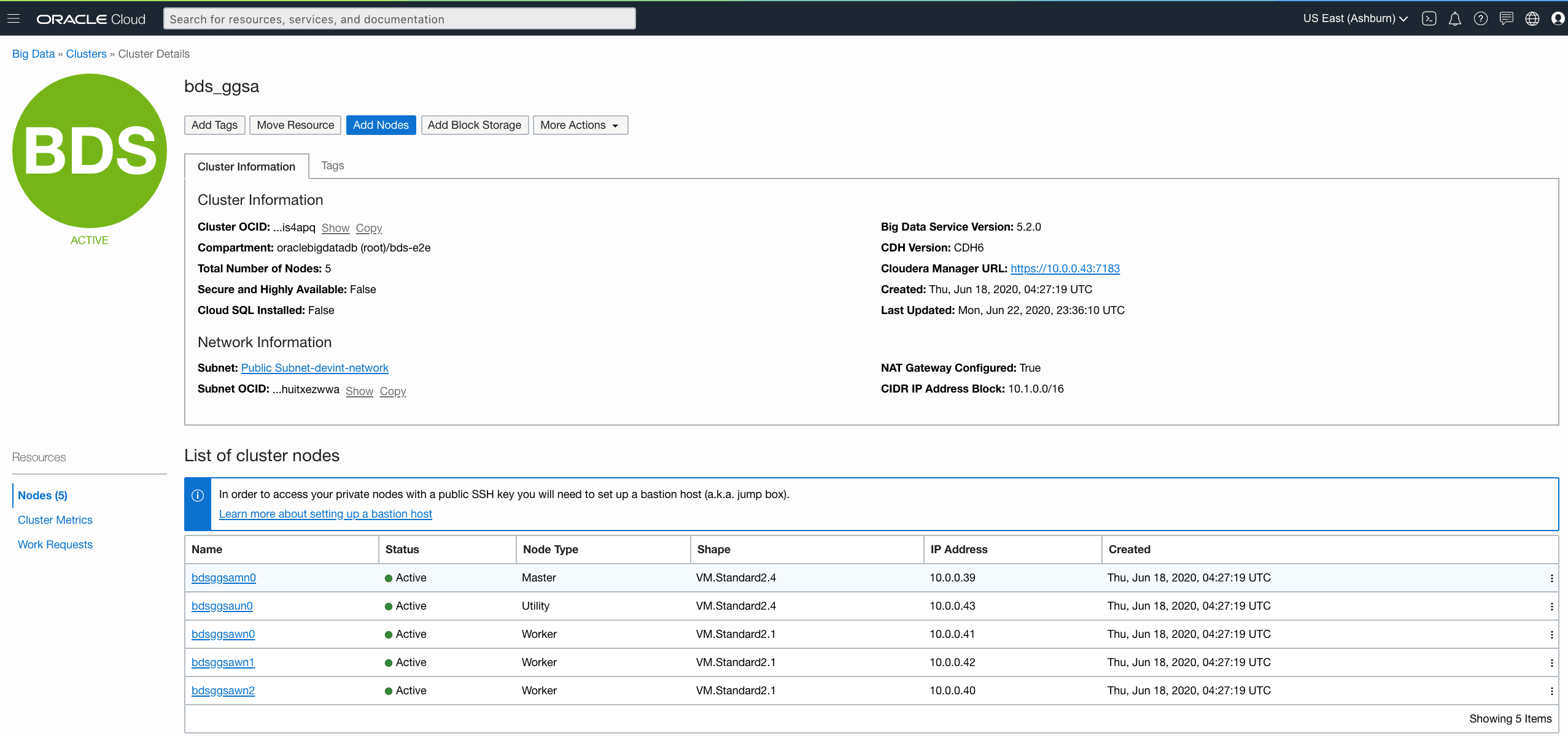

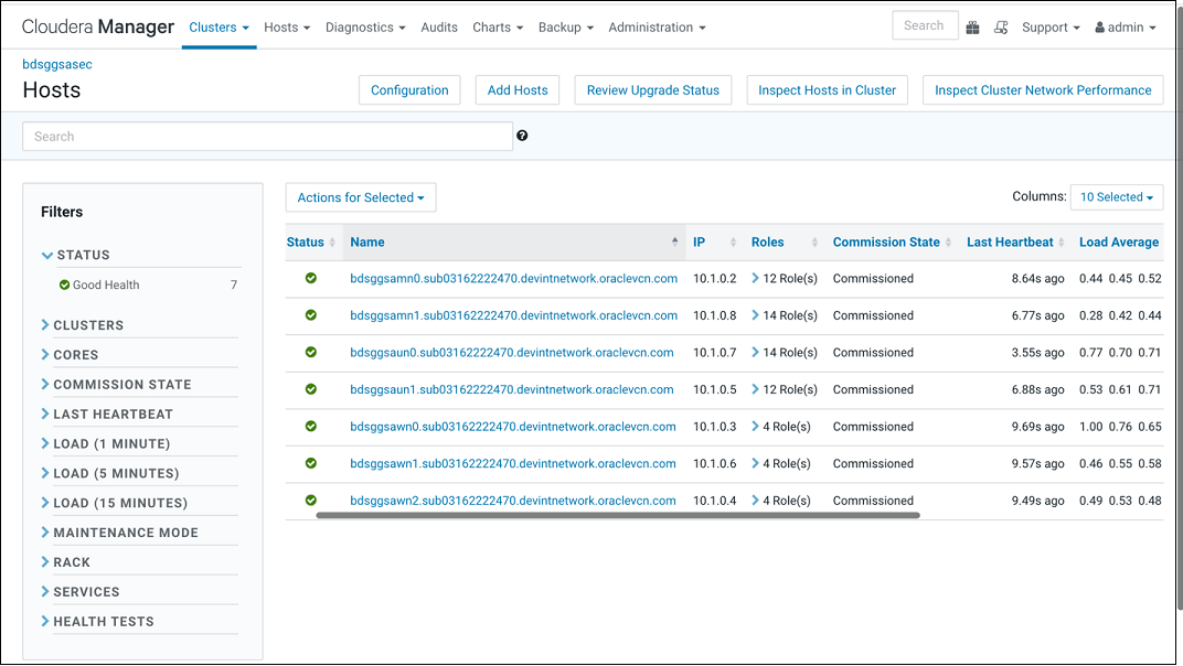

  1. Retrieve IP addresses of BDS cluster nodes from OCI console as shown in screenshot below. Alternatively, you can get the FQDN for BDS nodes from the Cloudera Manager as shown below.
    Cloudera Manager - FQDV for BDS Nodes

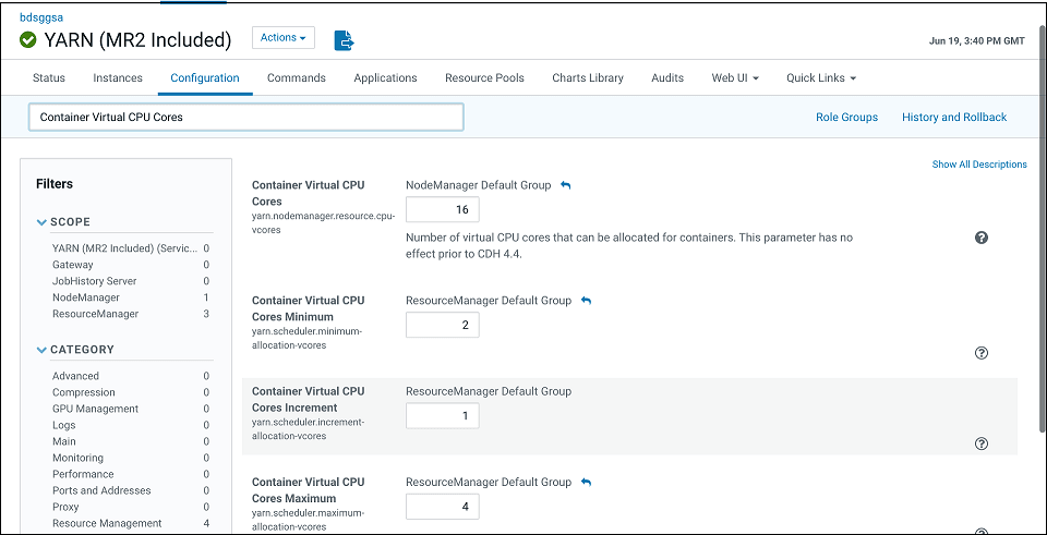

  2. Reconfigure YARN virtual cores using Cloudera Manager as shown below. This will allow many pipelines to run in the cluster and not be bound by actual physical cores.
    Reconfigure Yarn Virtual Cores
    • Container Virtual CPU Cores: This is the total virtual CPU cores available to YARN Node Manager for allocation to Containers. Please note this is not limited by physical cores and you can set this to a high number, say 32 even for VM standard 2.1.
    • Container Virtual CPU Cores Minimum: This is the minimum vcores that will be allocated by YARN scheduler to a Container. Please set this to 2 since CQL engine is a long-running task and will require a dedicated vcore.
      Container Virtual CPU Cores Maximum: This is the maximum vcores that will be allocated by YARN scheduler to a Container. Please set this to a number higher than 2 say 4.
    This change will require a restart of the YARN cluster from Cloudera Manager.

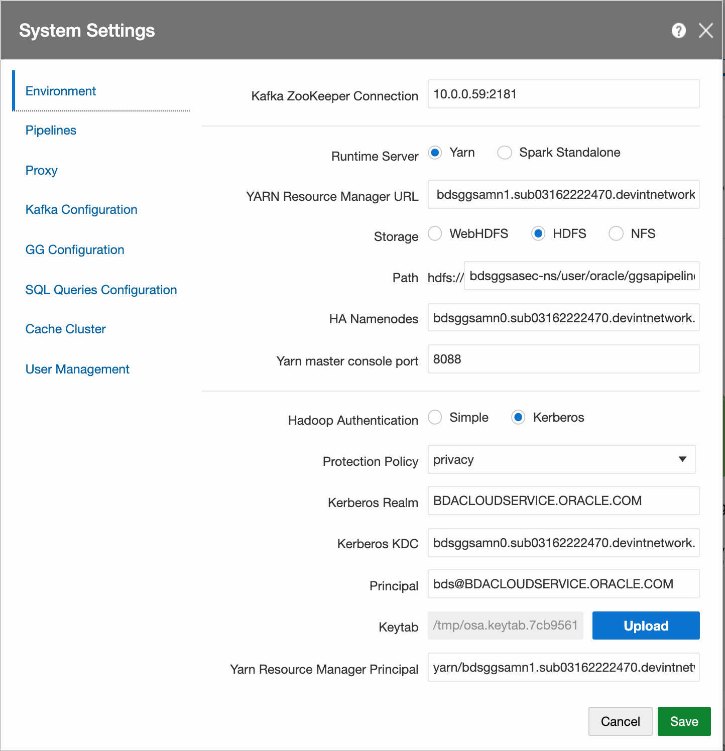

3.1.1.2.3.3 Configuring for Kerberized Big Data Service Runtime
In GGSA System Settings dialog, configure the following:
  1. Set Kafka Zookeeper Connection to Private IP of the OSA node or list of Brokers that have been configured for GGSA’s internal usage. For example, 10.0.0.59:2181.
  2. Set Runtime Server to Yarn.
  3. Set Yarn Resource Manager URL to Private IPs of all master nodes starting with the one running active Yarn Resource Manager. For example, bdsggsamn1.sub03162222470.devintnetwork.oraclevcn.com, bdsggsamn0.sub03162222470.devintnetwork.oraclevcn.com.
  4. Set storage type to HDFS.

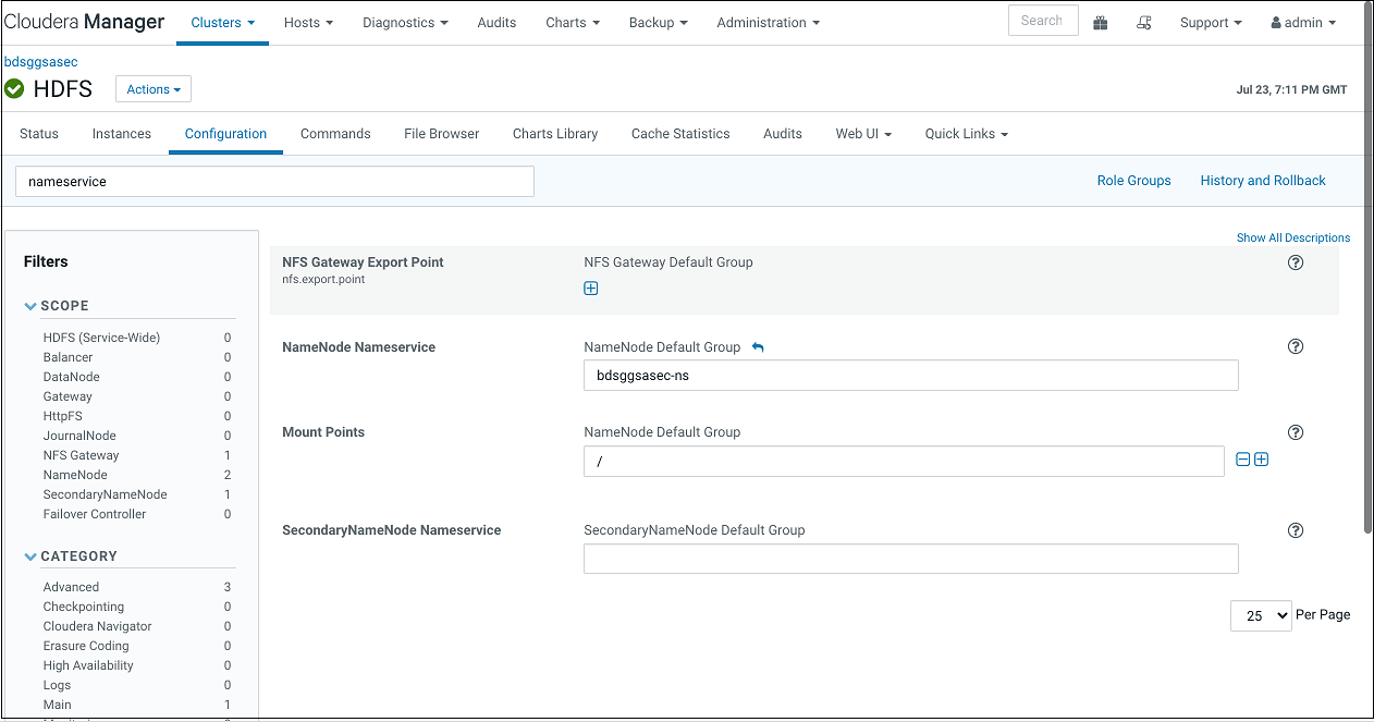

  5. Set Path to <NameNode Nameservice><HDFS Path>. For example, bdsggsasec-ns/user/oracle/ggsapipelines. The path will automatically be created if it does not exist but the Hadoop User must have write permissions. NameNode Nameservice can be obtained from HDFS configuration as shown in the screenshot below. Use search string nameservice in the search field.
    Set Path
  6. Set HA Namenode to Private IPs or hostnames of all master nodes (comma separated), starting with the one running active NameNode server. In the next version of GGSA, the ordering will not be needed. For example, bdsggsamn0.sub03162222470.devintnetwork.oraclevcn.com, bdsggsamn1.sub03162222470.devintnetwork.oraclevcn.com.
  7. Set Yarn Master Console port to 8088 or as configured in BDS.
  8. Set Hadoop authentication to Kerberos.
  9. Set protection policy to privacy. Please note this should match the value in HDFS configuration property hadoop.rpc.protection.
  10. Set Kerberos Realm to BDACLOUDSERVICE.ORACLE.COM.
  11. Set Kerberos KDC to private IP or hostname of BDS master node 0. For example, bdsggsamn0.sub03162222470.devintnetwork.oraclevcn.com.
  12. Set principal to bds@BDACLOUDSERVICE.ORACLE.COM. See this documentation to create a Kerberos principal (e.g. bds) and add it to hadoop admin group, starting with step Connect to Cluster's First Master Node and through the step Update HDFS Supergroup.
    You can hop/ssh to the master node using your GGSA node as the Bastion. You will need your ssh private key to be available on GGSA node though. Restart your BDS cluster as instructed in the documentation.
    [opc@bdsggsa ~]$ ssh -i id_rsa_private_key opc@bdsggsamn0.sub03162222470.devintnetwork.oraclevcn.com
  13. Make sure the newly created principal is added to Kerberos keytab file on the master node as shown:
    bdsmn0 # sudo kadmin.local
    kadmin.local: ktadd -k /etc/krb5.keytab bds@BDACLOUDSERVICE.ORACLE.COM
  14. Fetch the keytab file using sftp and set Keytab field in system settings by uploading the same.
  15. Set Yarn Resource Manager principal which should be in the format yarn/<FQDN of BDS MasterNode running Active Resource Manager>@KerberosRealm. For example, yarn/bdsggsamn1.sub03162222470.devintnetwork.oraclevcn.com@BDACLOUDSERVICE.ORACLE.COM.
    Sample System Settings Screen:Sample System Settings for Kerberized Production BDS Cluster

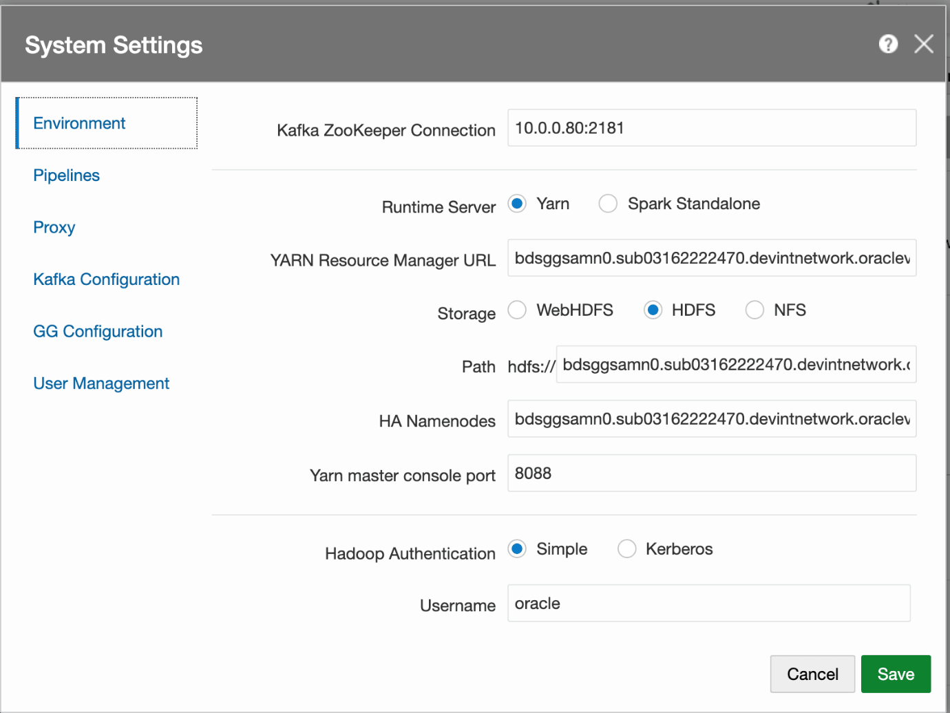

3.1.1.2.3.4 Configuring for Non Kerberized Big Data Service Runtime
In GGSA System Settingsdialog, configure the following:
  3. Set Yarn Resource Manager URL to Private IP or Hostname of the BDS Master node. For example, bdsggsamn0.sub03162222470.devintnetwork.oraclevcn.com.
  5. Set Path to <PrivateIP or Host Of Master><HDFS Path>. For example, 10.x.x.x/user/oracle/ggsapipelines or bdsggsamn0.sub03162222470.devintnetwork.oraclevcn.com/user/oracle/ggsapipelines .
  6. Set HA Namenode to Private IP or Hostname of the BDS Master node. For example, bdsggsamn0.sub03162222470.devintnetwork.oraclevcn.com.
  8. Set Hadoop authentication to Simple and leave Hadoop protection policy at authentication if available
  9. Set username to oracle.
  10. Click Save.
    Sample System Settings for Non Kerberized Dev/Test BDS Cluster
