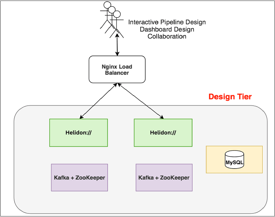

GoldenGate Stream Analytics' Design-tier is a multi-user environment that allows users to implement and test dataflow pipelines. The design-tier also serves dashboards for streaming data. Multiple users can build, test, and deploy pipelines based on the capacity of the Runtime-tier (YARN/Spark cluster) simultaneously.
GGSA uses Helidon as the web-server with support for HA. For production deployments of GGSA Design-tier, you require the minimum hardware configuration listed below:
  • Web server – Helidon
  • 2 nodes with 4+ cores and 32+ GB of RAM for running two instances of Helidon.
  • 1 node with 4+ cores and 16+ GB of RAM for running MySQL or Oracle meta-store.
  • 2 nodes with 4+ cores and 16+ GB of RAM for running two instances of Kafka and 3 instances of ZooKeeper. Please note this is a separate Kafka cluster for GGSA’s internal use and for interactively designing pipelines.
The two-node Kafka cluster can be avoided if customer already has a Kafka cluster in place and is fine with OSA leveraging that cluster for its internal usage.
Based on the above estimates, total cores for design-tier is 12 and approximate memory is 112 GB RAM. Helidon instances can be independently scaled as the number of users increase. Diagram below illustrates GGSA’s Design-tier topology.
GGSA’s Design-tier Topology
If you are on 4.x versions of Kafka, you do not need Zookeeper.

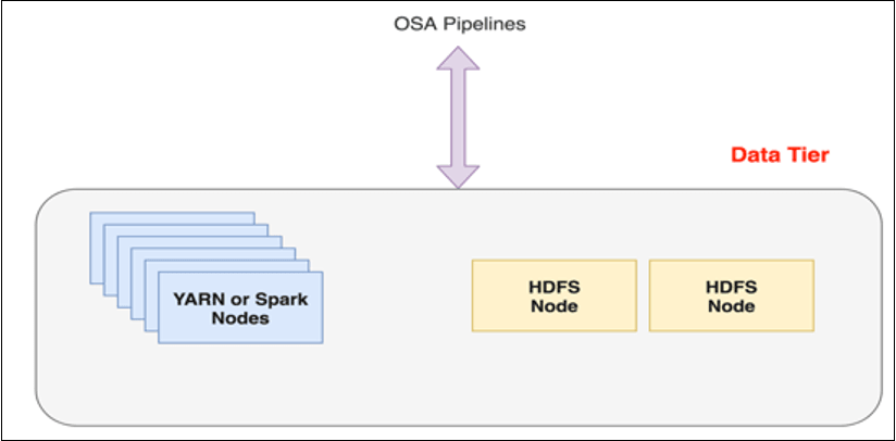

Data Tier
The deployed pipelines are run on the YARN or Spark cluster. You can use existing YARN/Spark clusters if you have sufficient spare capacity.
Sizing Guidelines
Use the following sizing guidelines to run GGSA pipelines. Ensure that the pipelines are deployed on shared storage, so that the pipeline code and libraries are accessible from all nodes in the YARN/Spark cluster. GGSA supports NFS for shared storage but if you want to use HDFS, the hardware needs two more nodes.
    • 2 nodes with 4+ cores, 16+GB RAM, and 500 GB local disk to run HDFS cluster, two instances of HDFS name and data nodes.
The Spark tier is where work happens and the Spark cluster size depends on
  • Number of pipelines that will simultaneously run
  • Logic in each pipeline
  • Desired degree of parallelism
For each streaming pipeline the number of cores and memory gets computed based on a required degree of parallelism. As an example, consider a pipeline ingesting data from customer’s Kafka topic T with 3 partitions using direct ingestion. Direct ingestion is where no Spark Receivers are used. In this case, the minimum number of processes that you need to run for optimal performance is as follows: 1 Spark Driver Process + 3 Executor processes, 1 for each Kafka Topic partition. Each Executor process needs a minimum of 2 cores.
The number of cores for a pipeline can be computed as
--executor-cores = 1 + Number of Executors * 2
In case of Receiver-based ingestion as in JMS, it is computed as
--executor-cores = 2 + Number of Executors * 2
This is rough estimates and environments where fine-grained scheduling is not available. In environments like Kubernetes, we have the luxury of more fine-grained scheduling.
The formula for sizing memory is
(Number of Windows * Average Window Range * Event Rate * Event Size) + (Number of Lookup/Reference Objects being cached * Size of Lookup Object).
Diagram below illustrates GGSA’s Data-tier topology.OSA's Data-tier Topology
