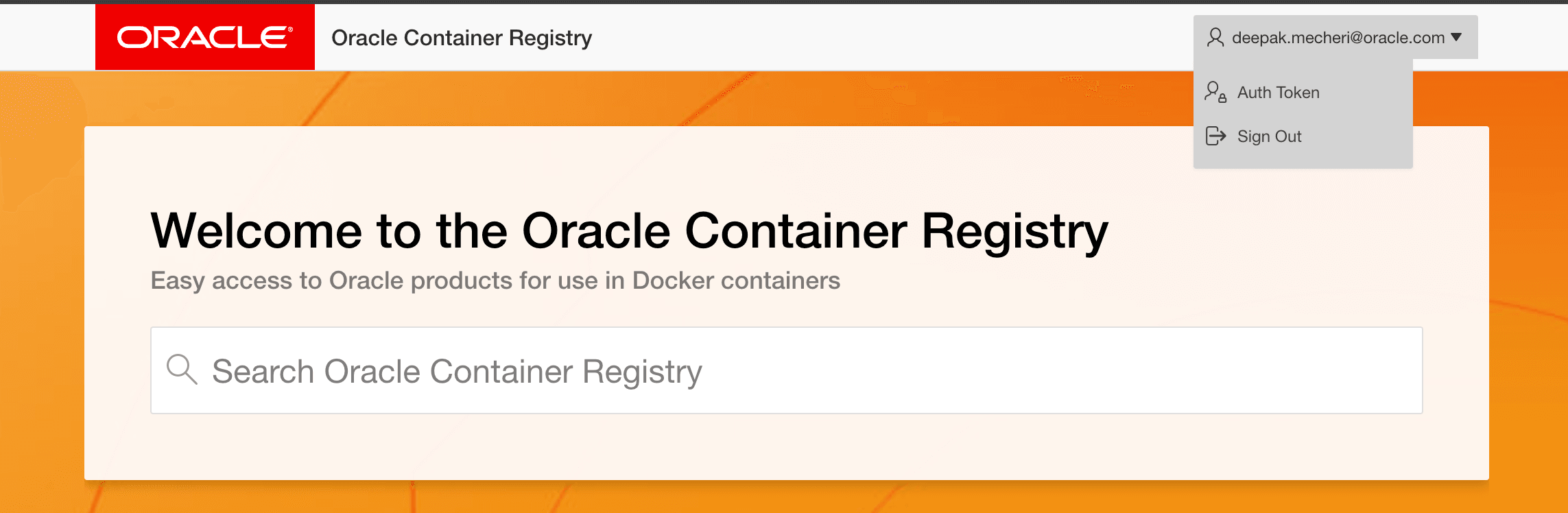

  3. Get access to Oracle Container Registry
    1. Go to https://container-registry.oracle.com/.
    2. Login and generate auth token.
