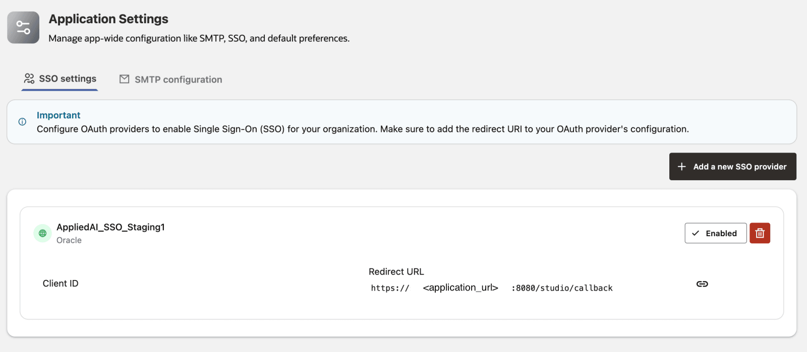

In Agent Factory, select Application settings from the left sidebar, then select the SSO settings tab.
Select Add a new SSO provider button and copy the Redirect URL at the bottom of the form.

Fill in the SSO credentials in the Add a new SSO provider form.
Required fields include:
Provider - select an SSO provider from the dropdown
Connection Name - name for your SSO connection
Client ID - your client ID
Client Secret - your client secret
Server Metadata URL -
https://<IDCS-URL>/.well-known/openid-configurationNote: The
/.well-known/openid-configurationsuffix in the Server Metadata URL field refers to an endpoint that may change depending on your SSO provider. -
Log Out URL -
https://accounts.google.com/logout(Only required for Google SSO)
See Adding a Confidential Application to learn more about Client ID and Client Secret.
Select Add Provider button to save the SSO provider.
