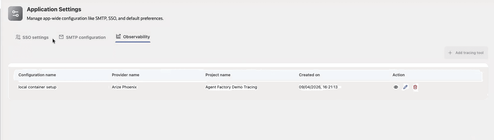

Note: At any point in time, you can have only one tracing tool configuration. The Add tracing tool button is disabled when a tracing configuration already exists. To add a different provider, delete the existing configuration, and then add the new provider configuration.
Sign in to Agent Factory as an administrator.
In the left navigation menu, select Application settings.
Select the Observability tab.

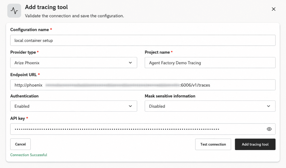

Click Add tracing tool.
In Configuration name, enter a name that identifies this configuration.
This name identifies the saved tracing configuration in Agent Factory. Use a short name that helps administrators recognize the target environment, such as
local container setuporproduction phoenix. -
For Tracing provider, select Arize Phoenix, Langfuse, or Comet Opik.
This field specifies the tracing backend.
In Project name, enter the project name where Agent Factory traces are stored.
The project name groups traces in the tracing provider. Use a project name that helps operators find traces for the deployment, environment, or team. For example, use
Agent Factory Demo Tracingfor a demonstration environment. -
In Endpoint URL, enter the provider’s HTTP traces endpoint. This can be a local deployment or a cloud server where you have set up the provider.
The endpoint URL specifies where Agent Factory exports traces. Include the
/v1/tracespath.http://<phoenix-host>:6006/v1/traceshttp://<langfuse-host>:3000/api/public/otel/v1/traceshttps://www.comet.com/opik/api/v1/private/otel/v1/tracesNote: Do not use
localhostin the URL unless the tracing provider and Agent Factory resolvelocalhostto the same runtime environment. Use a host name or IP address that Agent Factory can reach. If the host is outside the network, make sure to enable the Allow User Supplied Proxy and disable the Block Private Outbound Urls in Proxy Settings. See Configure Proxy. -
If the tracing provider requires authentication, enable authentication and enter the API key. If the tracing provider doesn’t require authentication, leave authentication disabled.
Authentication controls whether Agent Factory sends an API key when it exports traces. The API key provides the token used to authenticate to the tracing provider. To configure an API key, in Phoenix, select Settings in the left sidebar, then select System Keys. In the Create an API Key dialog, click Create Key. When the confirmation dialog appears, copy the new API key and paste it in the API key field.
If you want Agent Factory to redact sensitive trace payloads, enable Mask sensitive information.
This field redacts sensitive values before trace data is exported.
Enable masking when prompts, model responses, system messages, tool arguments, or tool results can contain sensitive data. When masking is enabled, Agent Factory redacts LLM inputs and outputs, tool inputs and outputs, and OpenInference attributes such as
input.value,output.value,llm.prompts,llm.completions, andtool.parameters.Agent Factory keeps non-sensitive operational metadata visible so traces remain useful. For example, traces can still include token counts, model identifiers, latency, trace IDs, span IDs, and session IDs.
Click Test connection.
Agent Factory validates network reachability, the endpoint path, and authentication.
Review the connection test result.
If the connection test fails, use the returned message to correct the configuration.
Connection Failed: 401 Unauthorized. Please check your API key.: Check whether authentication is enabled and whether the API key is correct.Connection Refused: Please ensure the tracing server is running and accessible at the specified endpoint.: Confirm that the tracing server is running and that Agent Factory can reach the endpoint URL.- Network or endpoint errors: Check the host name, port,
/v1/tracespath, firewall rules, and container networking.
If the connection test succeeds, click Add Tracing Tool.
After the configuration is saved, Agent Factory shows it in the Observability table with the configuration name, provider name, project name, creation date, and actions to view, edit, or delete the configuration.
