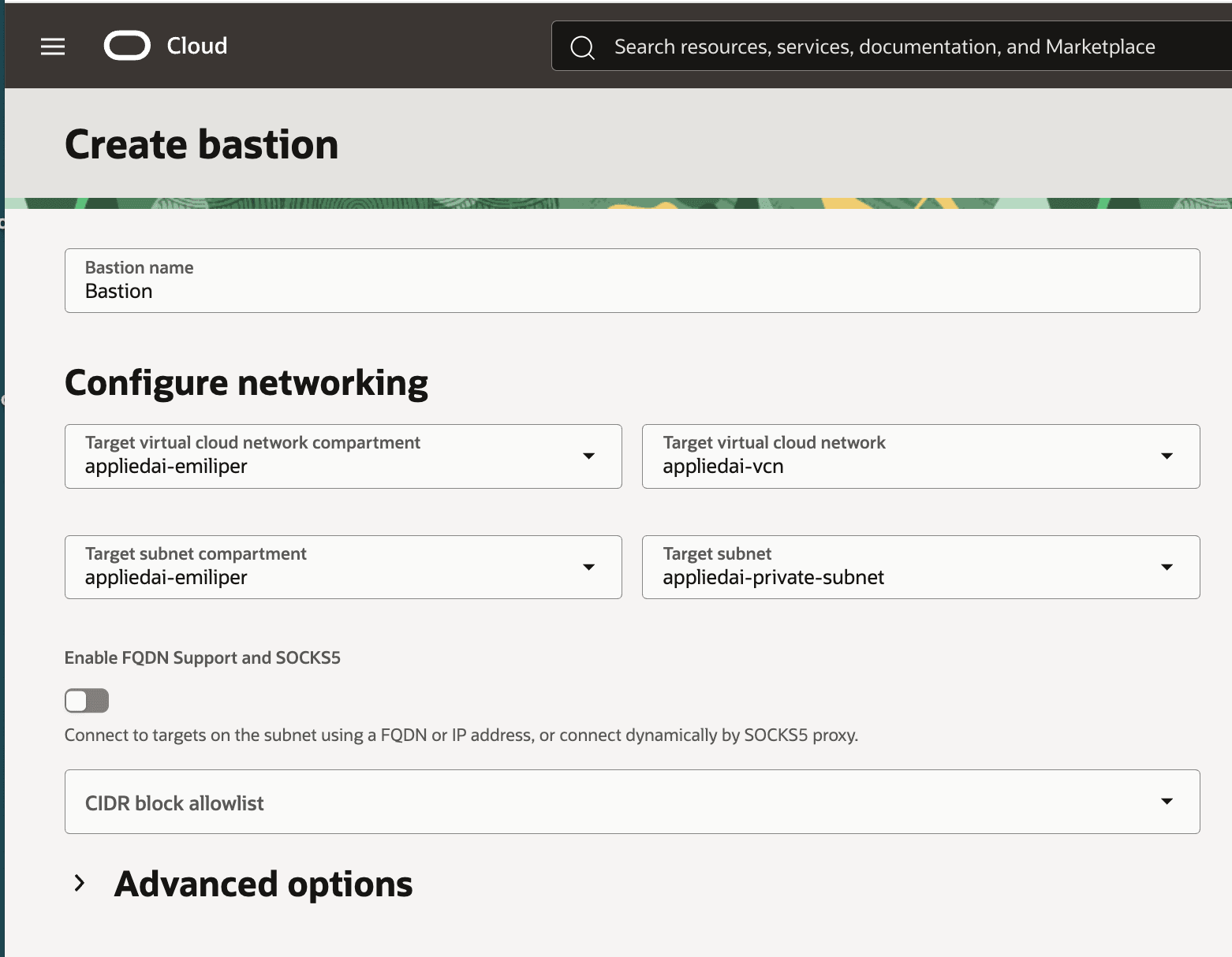

Configure Bastion
A Bastion is an OCI resource that provides restricted and time-limited secure access to resources that don’t have public endpoints and require strict resource access controls, such as VMs created in private subnets.
See OCI documentation for details.
Target VCN
Both the public and private subnets must be within the same VCN. -
Target subnet
Select the private subnet (the one hosting the private VM). -
Allowlist
Restrict access to the Bastion by allowlisting a single public IP (your current client IP).

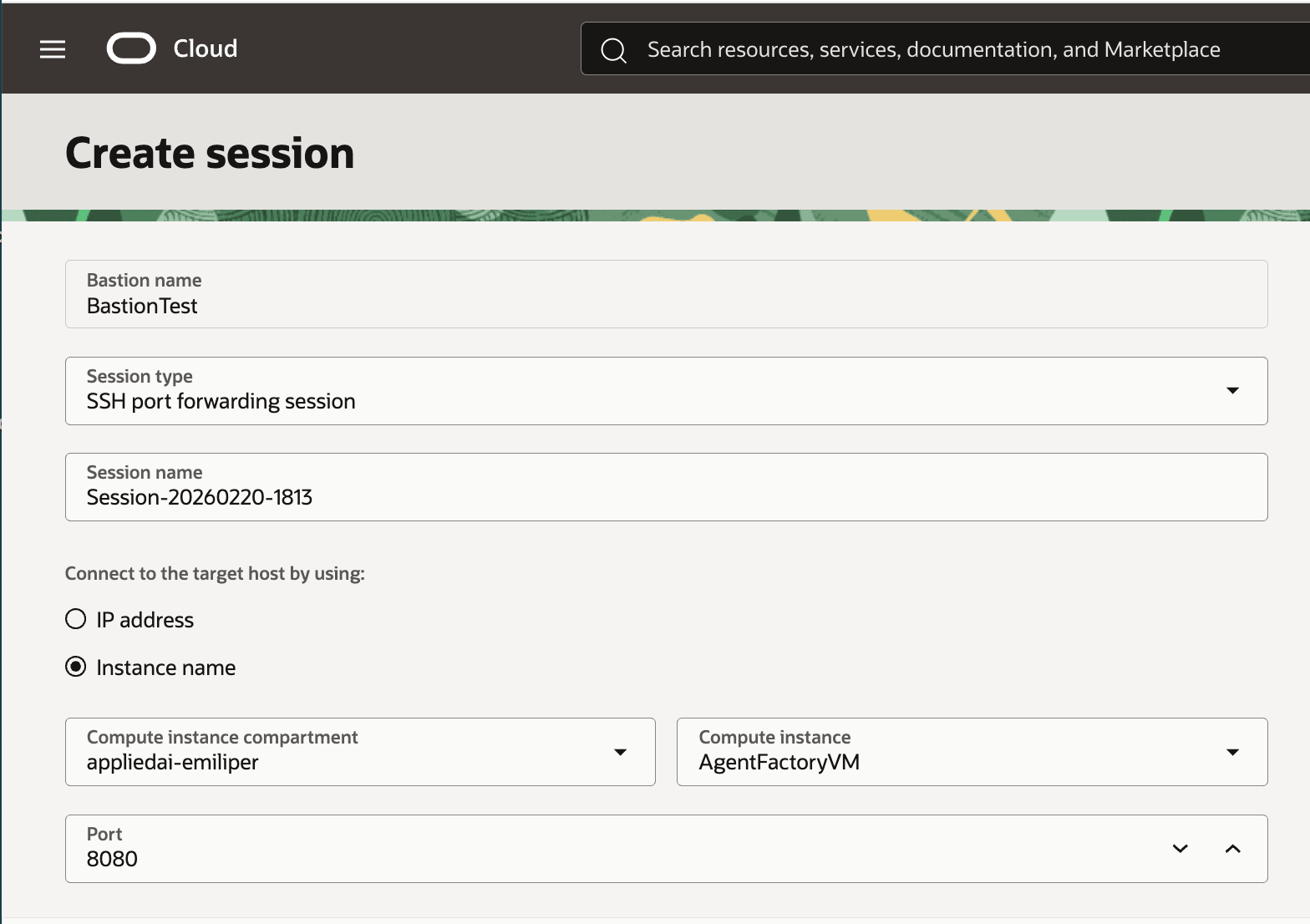

Create a Bastion Session
A Bastion session is a secure, temporary SSH connection provided by the OCI Bastion service. It allows you to access private compute instances without exposing them to the internet, requiring public IPs, or a VPN connection. See OCI documentation for details.
After the Bastion is active, create a session for each port you want to forward. Note that Bastion sessions are ephemeral by design.
To access the Agent Factory user interface (UI), you must forward port 8080. (Optional) Forwarding port 22 is also recommended for SSH access to the VM.
- Select SSH port forwarding session as the Session type
- Select Instance name
- Upload
.pubfile - (Optional) Increase session length of time.

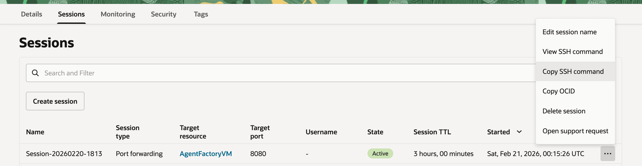

Once the session is active, click the vertical dots and copy the SSH command. The command is structured as follows:
ssh -i <privateKey> -N -L <localPort>:<private_vm_ip>:<port> -p <port> ocid1.bastionsession.<bastion_ocid>@host.bastion.<oci_region>.oci.oraclecloud.com
OCI provides a prepopulated command. Replace <privateKey> with the path to the private SSH key matching the uploaded public key, and <localPort> with the local port on your host (e.g., 8080 if available; any free port works)
(Optional) For port 22 forwarding, use local port 2222.

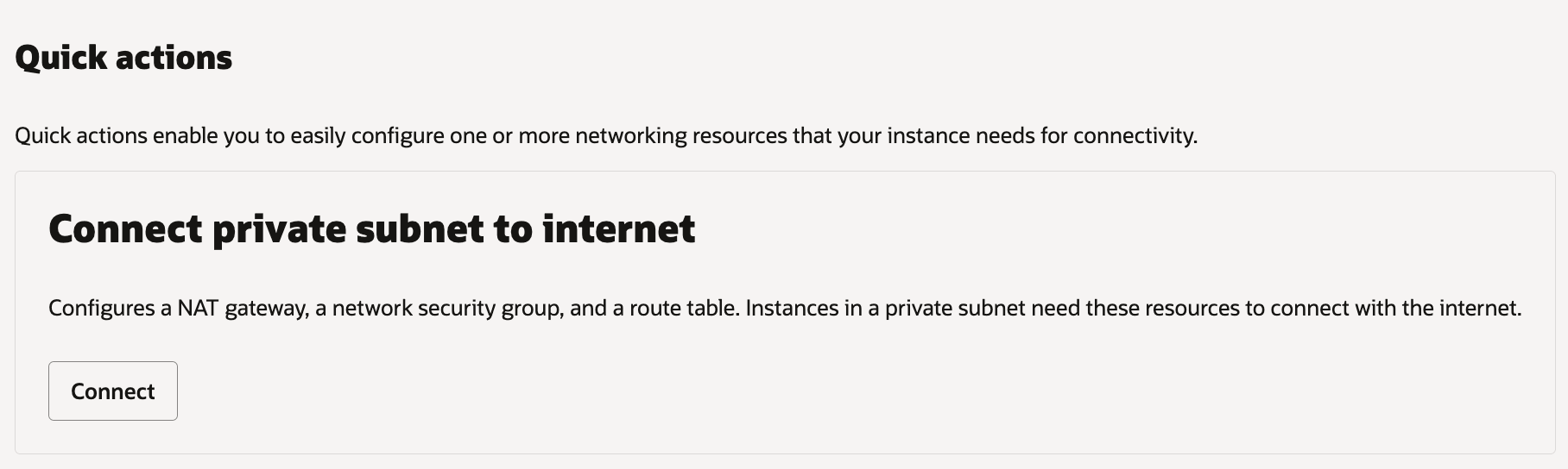

Configure NAT Gateway
A Network Access Translation (NAT) Gateway enables cloud resources without public IP addresses to access the internet without exposing them to incoming connections. This allows Agent Factory (installed on the private VM) to connect to your database, LLM endpoint, and features like web sources.
From the private instance’s description, under the Networking tab, use Quick actions > Connect private subnet to internet. This automatically creates and configures required resources. See the OCI Documentation for details.

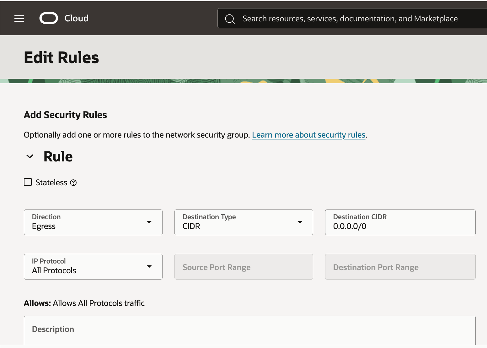

Follow the steps below if your network requires custom configuration:
- On the VCN resource page, under Security > Network Security Groups, create a new group. Add an egress security rule:
- Destination type: CIDR
- Destination CIDR: 0.0.0.0/0
- Stateless: No
- Protocols: All (or customize as needed) The egress rules provide connectivity to the database and LLM endpoints.

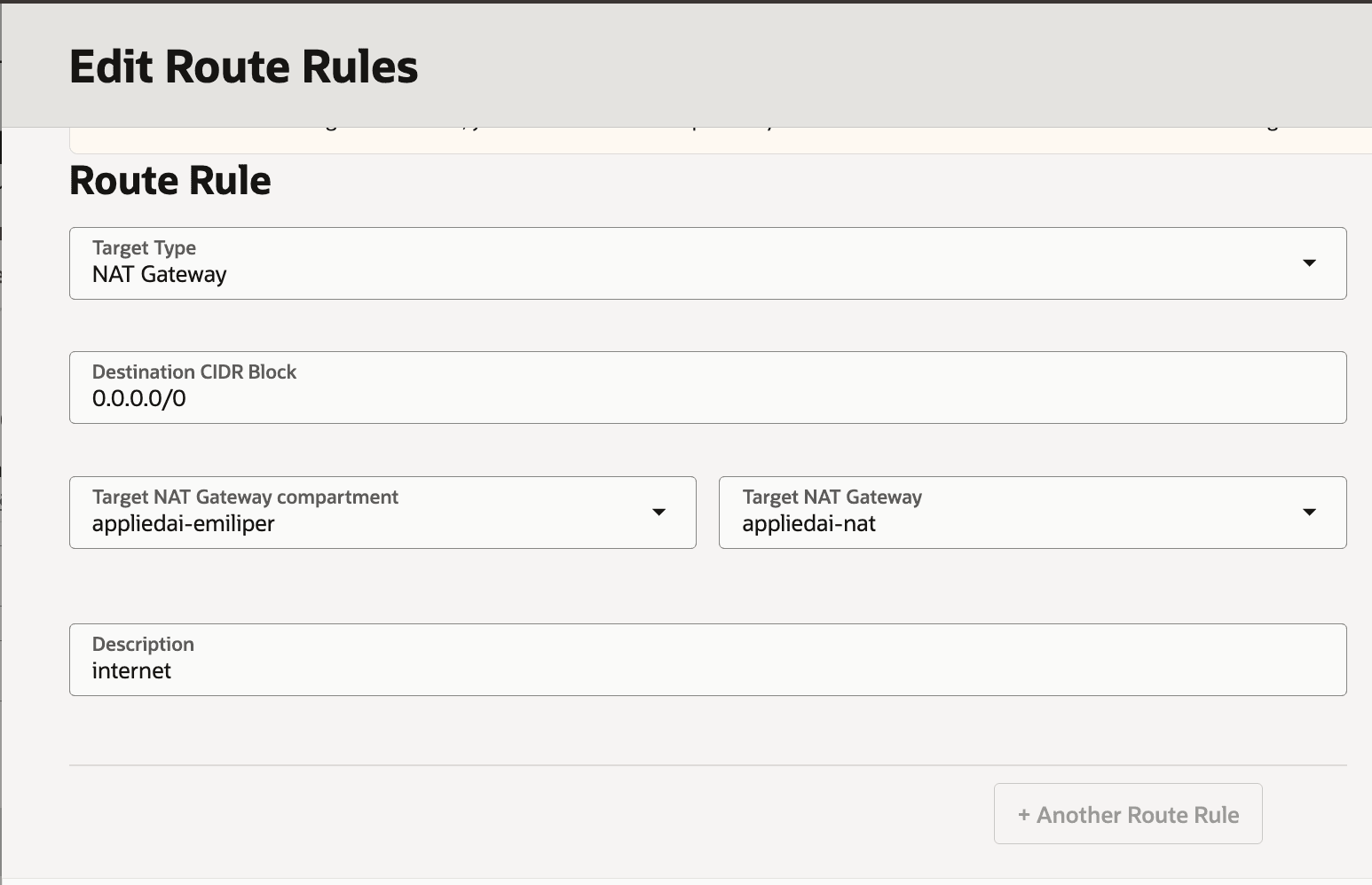

On the VCN description page, under Gateways > NAT Gateways, create a new NAT Gateway in the private subnet.
- Edit the associated route table: Add a rule such as:
- Target Type: NAT Gateway
- Destination CIDR Block: 0.0.0.0/0
- Target: your NAT Gateway
- Description: (e.g., “Route private subnet traffic to NAT”)
