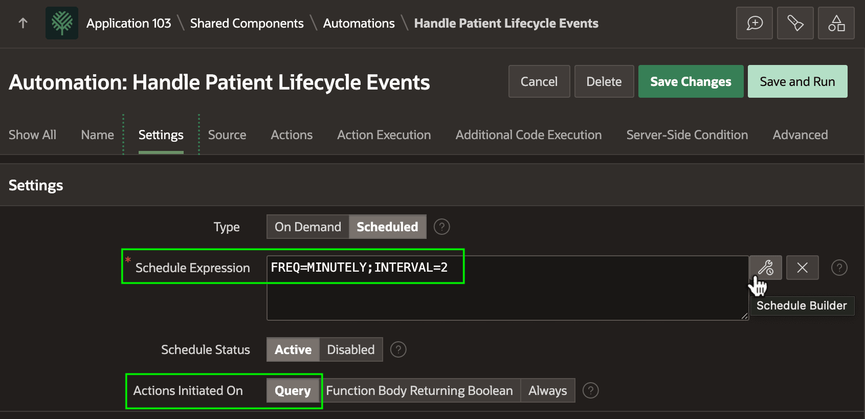

The Handle Patient Lifecycle Event automation shown below is a shared component that defines a recurring background job. It runs periodically based on the Schedule Expression you create with the Schedule Builder dialog, or type in directly. This particular job runs in the background every two minutes.
The Query choice for Actions Initiated On means the automation's actions execute once for each row in the query you define on the Source tab.
Figure 25-149 Lifecycle Events Handler Automation – Settings

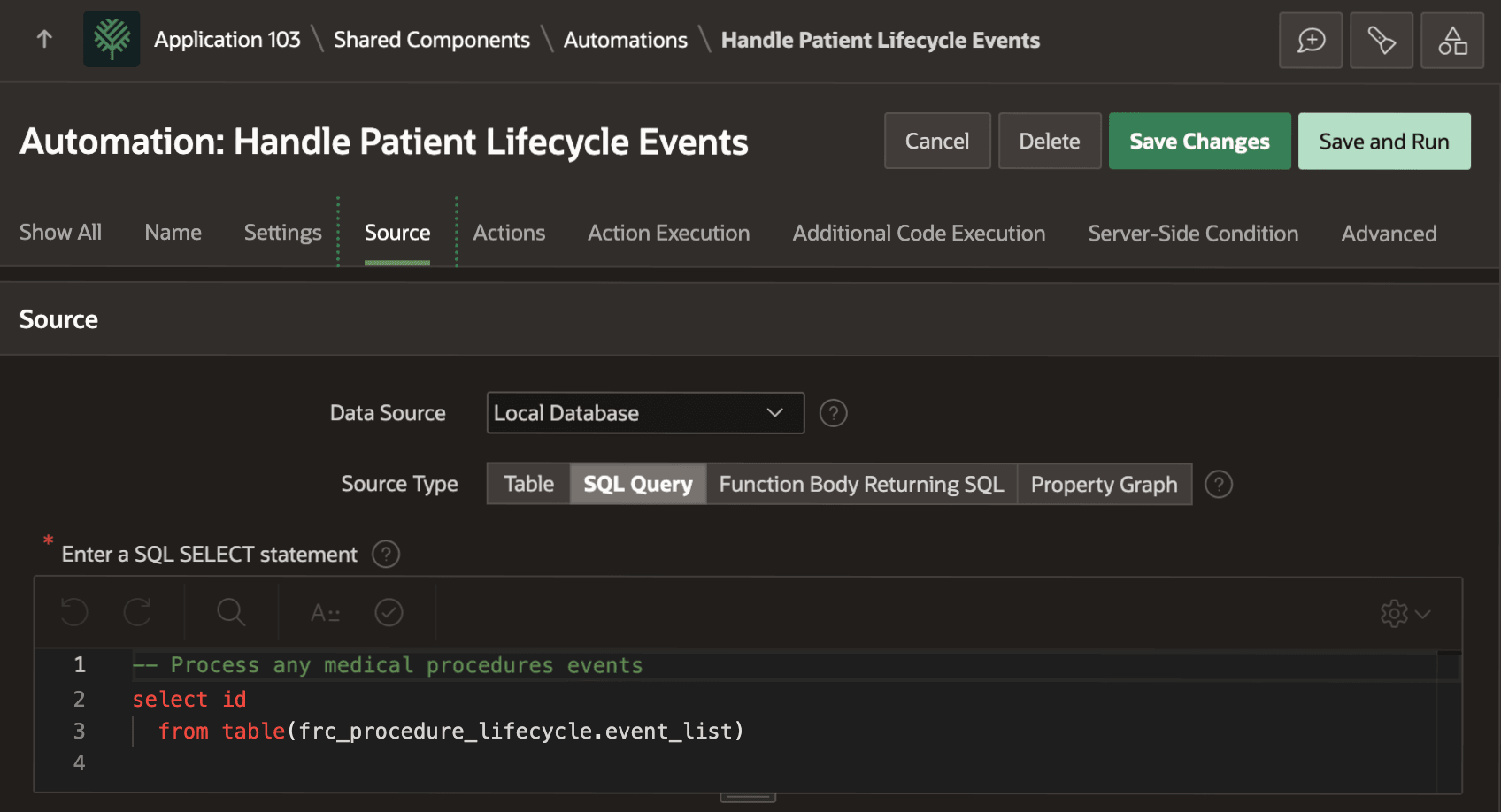

On the Source tab you specify the simple query that retrieves the patient procedure lifecycle events to process during the current automation job run. The query uses the TABLE() operator to select the event ID values to process from the EVENT_LIST function in the FRC_PROCEDURE_LIFECYCLE package. The simple query is:
select id
  from table(frc_procedure_lifecycle.event_list)
Figure 25-150 Lifecycle Events Handler Automation – Source

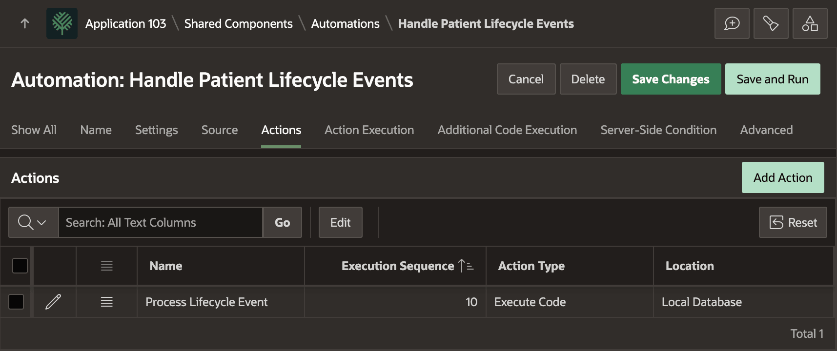

An automation can have multiple actions, each of which can contain a server-side condition to control whether it executes or not for any given row. However, in this simple use case, you only need a single Process Lifecycle Event action shown below. Like any action, it can reference the source query column values for the current row as bind variables. This action uses the Execute Code type to run the single line below, passing the value of the current event ID:
frc_procedure_lifecycle.process_event(:ID);
Figure 25-151 Lifecycle Events Handler Automation – Actions

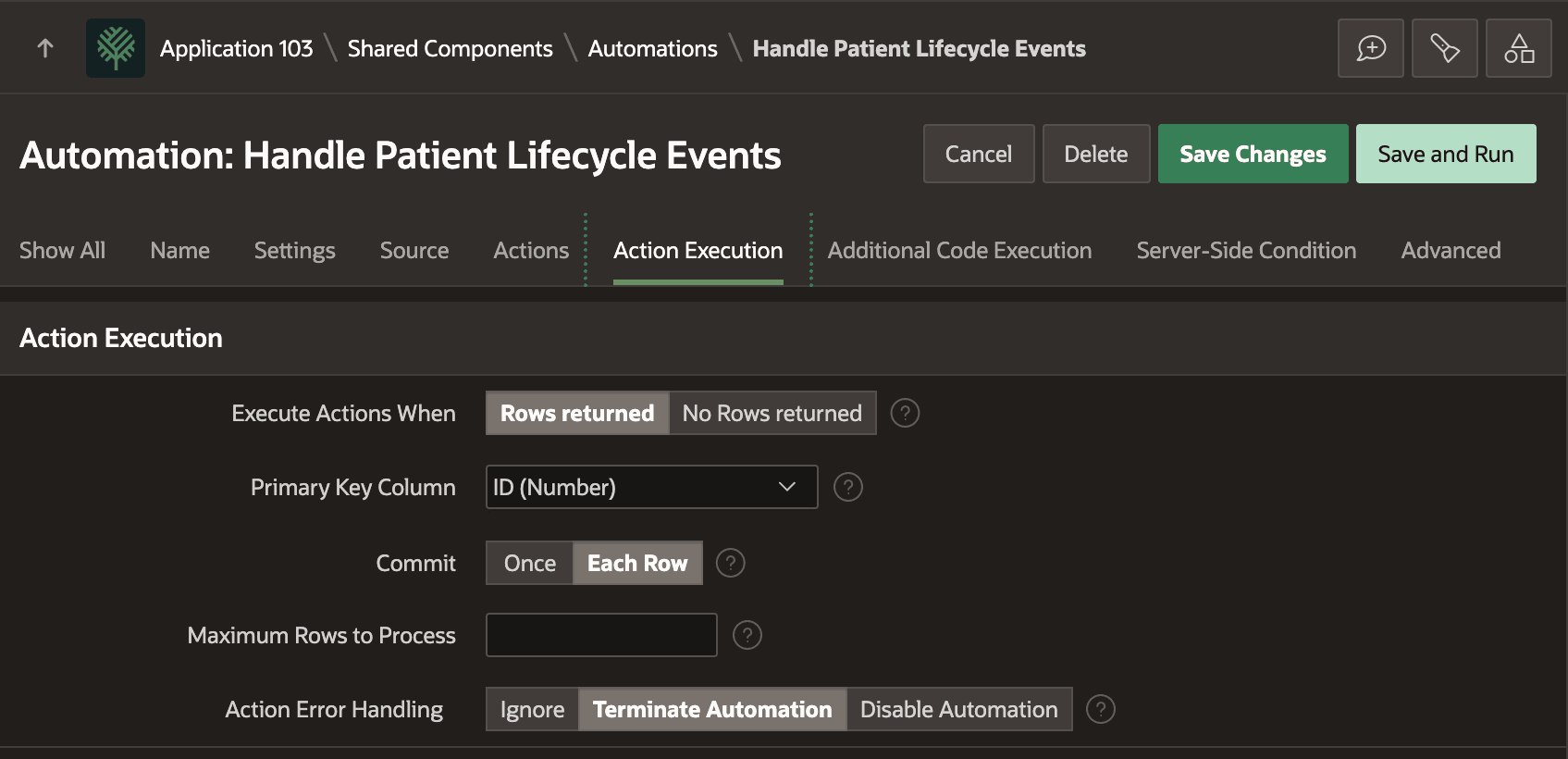

On the Action Execution tab, as shown below, you configure error handling and commit behavior for the job. By committing after each event row is processed, you ensure that a later event's error does not rollback the successful processing of earlier events.
Figure 25-152 Lifecycle Events Handler Automation – Action Execution
