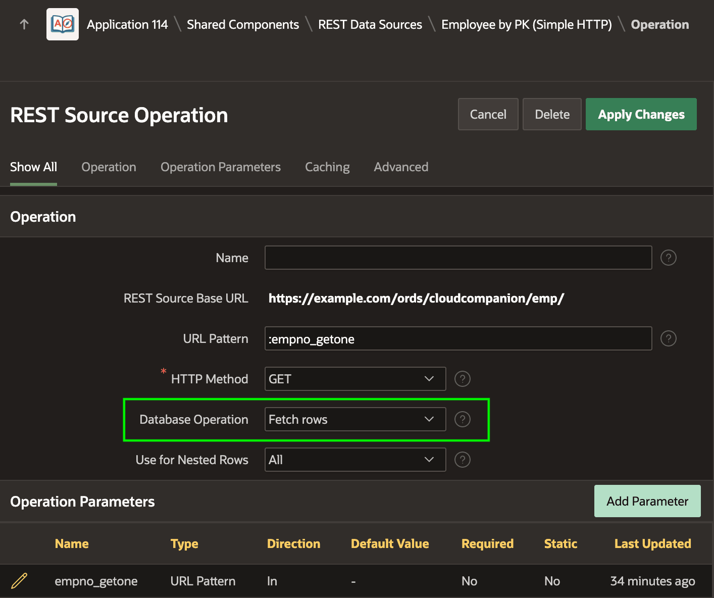

The Employee by PK (Simple HTTP) REST Data Source, with Static ID employee_by_pk_simple_http has just a single GET operation with Database Action of Fetch rows. As shown below, it's configured to use the URL Pattern parameter empno_getone in the URL to retrieve a single employee.
Figure 13-24 Fetch Rows GET Operation to Retrieve One Employee by PK
At runtime, by setting the empno_getone parameter to a value like 7788 as the example above is doing, if debug tracing is enabled you would see the APEX engine requests the URL:
making GET request to https://example.com/ords/cloudcompanion/emp/7788

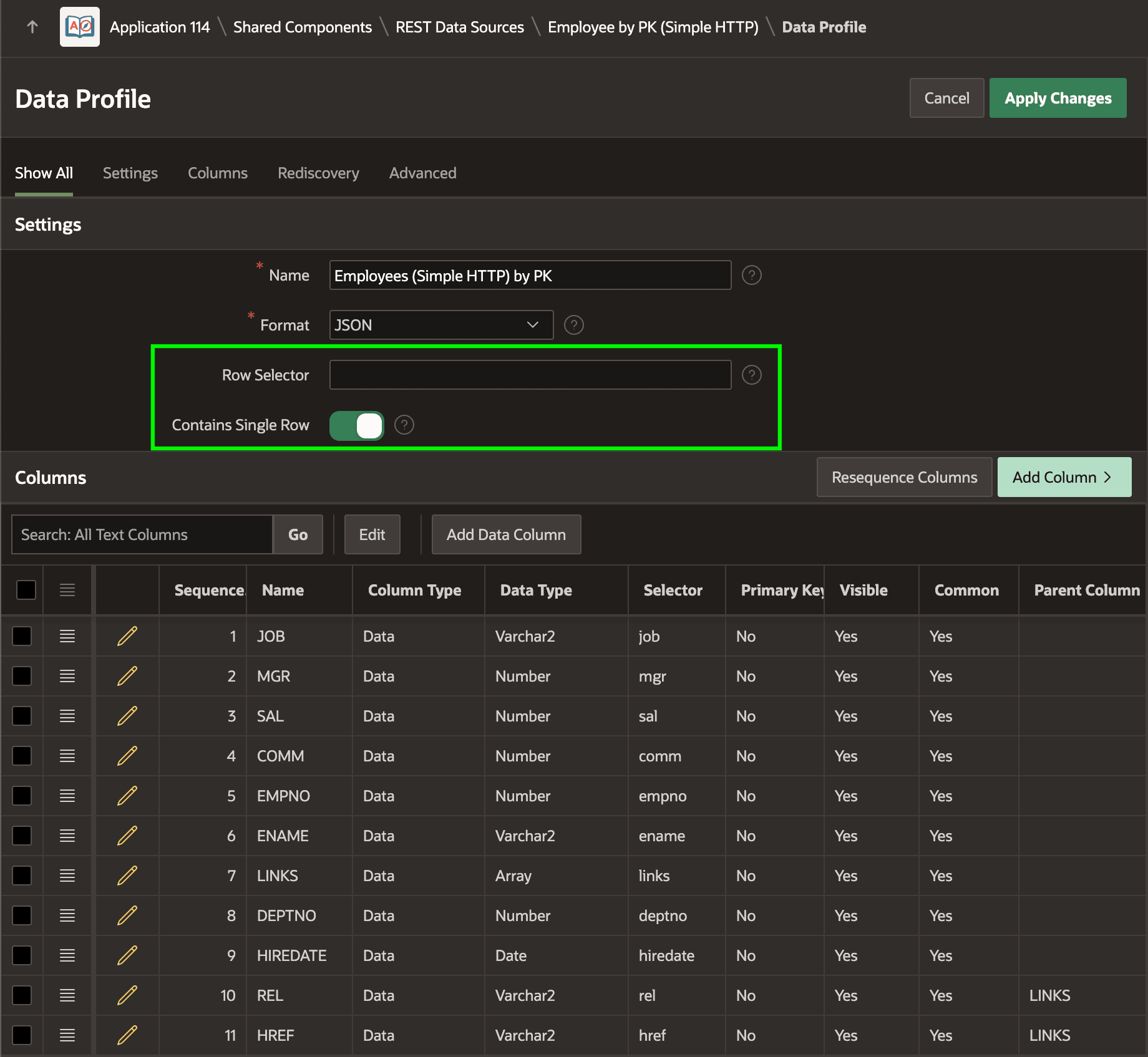

This means the Employee by PK (Simple HTTP) REST Data Source needs a Data Profile that caters for this different, single-row response. As shown below, the Data Profile for this REST Data Source omits the Row Selector and enables the Contains Single Row switch.
Figure 13-25 Data Profile for Employee by PK (Simple HTTP) REST Data Source
