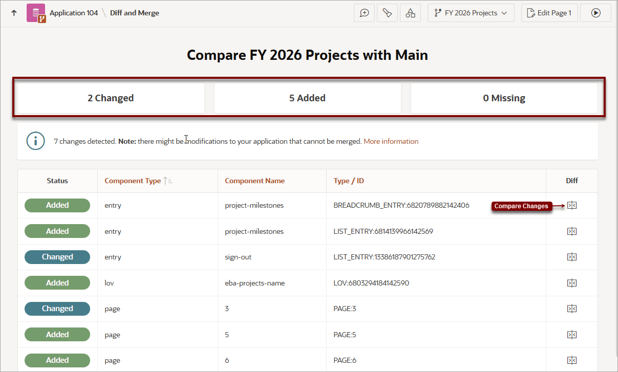

  2. Click the Working Copy: Name menu and select Compare Working Copy with Main.
    You can also select Compare Changes from the side bar. Alternatively, if viewing a page in Page Designer, click the Working Copy: Name menu and select Compare Working Copy with Main.
    App Builder exports the Main app and Working copy and compares the two versions. The Compare Project Name with Main dialog appears summarizing what has been changed, added, or is missing.
  3. To view a Diff of the changes, click the Compare Changes icon.
    The View Differences window appears. Click Close to exit the window.
