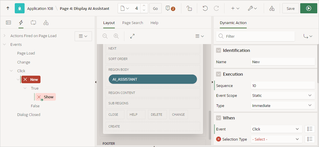

    2. Under Events, right-click Click and select Create Dynamic Action.
      A dynamic action named New appears in the left pane. The Property Editor displays Dynamic Action attributes.
  5. In the Property Editor, edit the Dynamic Action attributes:
    1. Identification, Name - Enter the name of the dynamic action. For example, enter: Display AI Assistant
    2. When, Event - Specify the event that causes the dynamic action to fire. For this example, accept the default, Click
    3. When, Selection Type - Select the type of page element or construct to be used to trigger the event. For this example, select Button.
    4. When, Button - Select the type of page element or construct to trigger the event. For this example, select the button you previously created, AI_ASSISTANT.

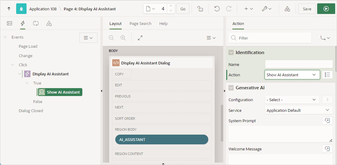

  6. Edit the True action, Show. In the Dynamic Action tab, click the Show action.
    Action attributes displays in the Property Editor.
  7. Identification, Action - Select action you want to perform.
    For this example, select Show AI Assistant.
  8. Generative AI attributes:
    1. Generative AI, Service - Select the Generative AI Service to be used by the AI Assistant. Application Default uses the Generative AI Service specified on the AI page in the application attributes. See Configuring AI Attributes for an Application.
    2. Generative AI, System Prompt - Specify the system prompt to be used by the AI Assistant. The System Prompt gives the AI a context. This message does not display on front end, but is sent to all AI service requests on the back end.
      You can enter text or use this attribute in conjunction with Initial Prompt to utilize substitutions using application items, page items, or system variables.
    3. Generative AI, Welcome Message - Specify an optional welcome message shown by the AI Assistant. For example, enter: How may I help you today?
      Note this attribute also supports substitutions using application items, page items, or system variables
    4. Generative AI, Items to Submit - Enter items to be set into session state when the dynamic action is executed.
      For multiple items, separate each item name with a comma. Type in the name or pick from the list of available items. If you pick from the list and there is already text entered, then a comma is placed at the end of the existing text, followed by the item name returned from the list. The item values are then available for use in AI backend processing, including within the System Prompt or RAG Sources.
