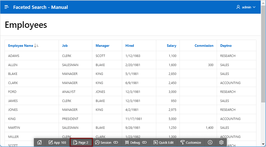

  3. View the new page.
    1. On the Application home page, select the new page, 2 - Employees.
      The page displays in Page Designer.
    2. Click Save and Run Page on the right side of the Page Designer toolbar.
    3. When prompted, enter your workspace username and password and click Sign In.
      The Employees report appears.
    4. Return to Page Designer. Click Page X on the Developer toolbar where X is the page number.

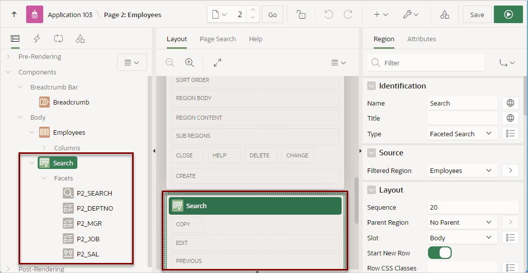

  4. Add a search region:
    1. In the Rendering tab (or left pane), right-click Components and select Create Region.
    2. Select the new region. Edit the following Region attributes in the Property Editor (or right pane):
      • Identification, Name - Enter Search
      • Identification, Type - Select Faceted Search.
      • Source, Filtered Region - Select Employees.
    3. Update the region appearance:
      • Appearance, Template Options - Click Use Template Defaults, Scroll - Default.
        The Template Options dialog appears.
      • Common, General - Select Remove Body Padding.
      • Common, Header - Select Hidden but accessible.
      • Click OK.
  5. Update the facet for searching multiple columns:
    1. Select PX_SEARCH where X represents the page number.
    2. Source, Database Column(s) - Enter ENAME,JOB,MGR,DEPTNO
    3. Save your changes. Click Save.
  6. Add a facet to filter the DEPTNO column:
    1. In the Rendering tab, right-click Facets and select Create Facet.
    2. Select the new facet and edit the following attributes in the Property Editor:
      • Identification, Name - Enter PX_DEPTNO where X represents the page number.
      • Identification, Type - Accept the default, Checkbox Group.
      • Label, Label - Enter Department
      • List of Values, Type - Select SQL Query.
      • List of Values, SQL Query - Enter SELECT dname, deptno FROM dept

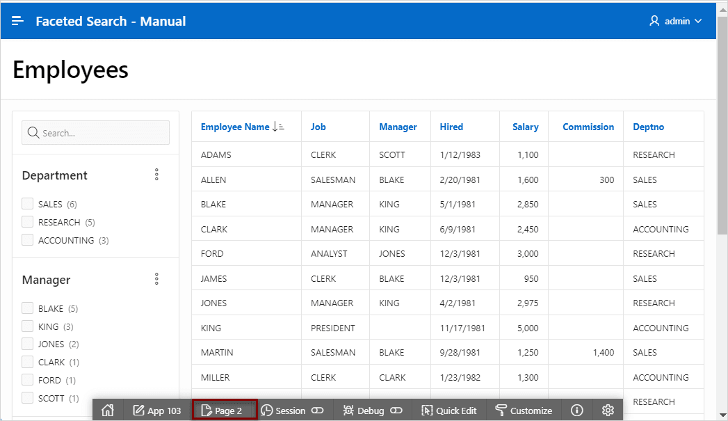

  11. Make the Search region narrower and then update region appearance. Select the Search region and update the following Region attributes:
    1. Layout, Column - Enter 1
    2. Layout, Column Span - Select 3.
  12. View the page.
    1. Click Save and Run Page in the upper right corner.
    2. If prompted, enter your workspace username and password and click Sign In.
      The revised page appears. Notice that the Search region contains the following facets: Search, Department, Manager, and Salary.
      Description of faceted_search_manual_1.png follows

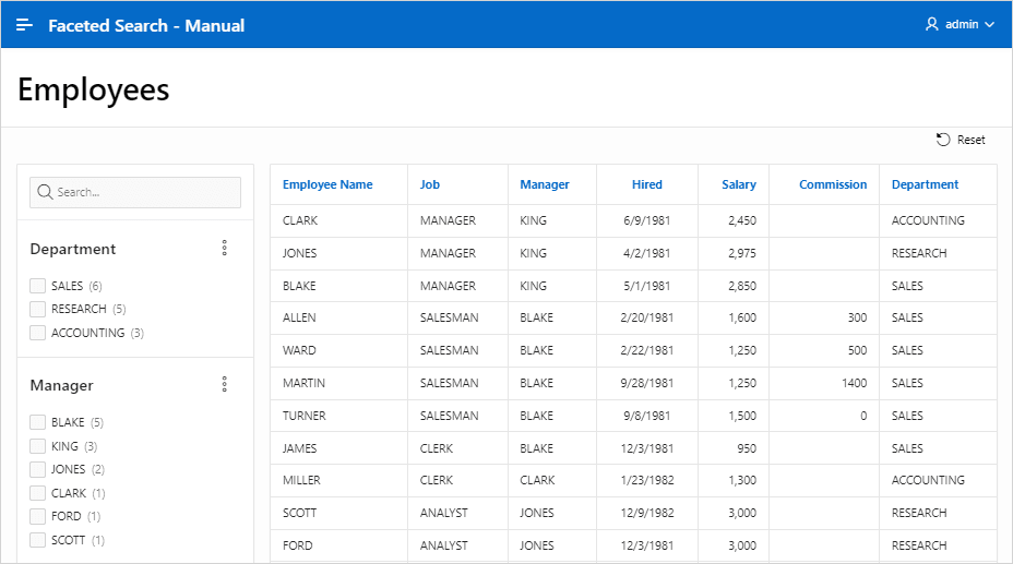

  15. View the revised page.
    1. Click Save and Run Page.
      The faceted search page appears. Notice the new Reset button displays in the upper right above the report.
    3. Test the page. Select facets and then click Reset.
