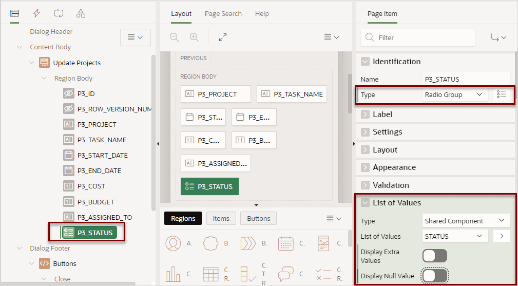

  5. Update the form item to reference the list of values:
    1. Return to Page Designer. Click the Application XX breadcrumb where XX is the page number.
    2. On the Application home page, select the page where you want to add list of values.
    3. In the Rendering tab, select the form page item. For example, select P7_STATUS.
    4. In the Property Editor, edit the following attributes:
      • Identification, Type - Select Radio Group.
      • List of Values, Type - Select Shared Component.
      • List of Values, List of Values - Select STATUS.
      • List of Values, Display Extra Values - Disable this option.
    5. Click Save and then run the page.
    As shown in the folllowing example, the form item, Status, now displays as Radio Group with four values: Pending, Open, On-Hold and Closed.
    Description of static_lov_radio_group.png follows
