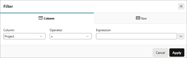

  2. For Filter Type, select Column.
  3. In the Filter dialog, specify a column, an operator, and an expression and click Apply.
    Notice the filter that displays in the Report Settings area above the report. You can show or hide the filter details by clicking the arrow to the left of the filter name.
