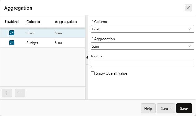

  2. In the Aggregation dialog:
    1. Column – Select the column to define against
    2. Aggregation – Select the type of aggregation to apply
    3. Tooltip – (Optional) Add a label that appears when you hover the mouse over the aggregation.
    4. (Optional) Show Overall Value – Select to display the grand total of a column
  3. To add another aggregation:
    1. Click the Add icon (+).
      A new Aggregation appears in the list.
    2. Define the new aggregation as described in the previous step.
  4. Click Save.

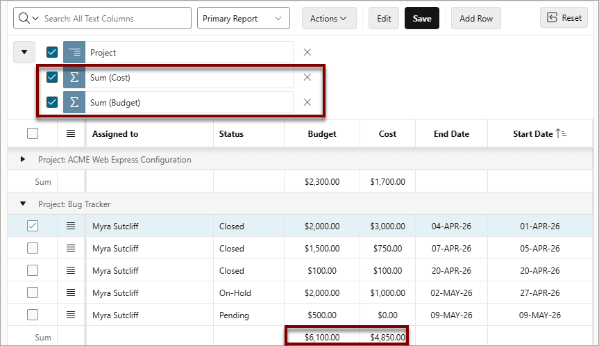

The result of the aggregation appears at the bottom of the last page of the report.
The following example is an interactive grid with two sum aggregations applied to two different columns (a control break has also been applied to simplify the presentation):

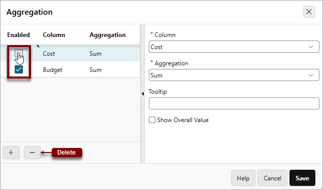

  3. Do one of the following:
    • To hide an aggregation from view in the grid, click the adjacent checkbox in the Enabled column. This disables the aggregation and stores it for future use in the Aggregation dialog.
    • To remove the selected aggregation from the grid completely and permanently, click the Delete icon (—).
  4. Click Save.
