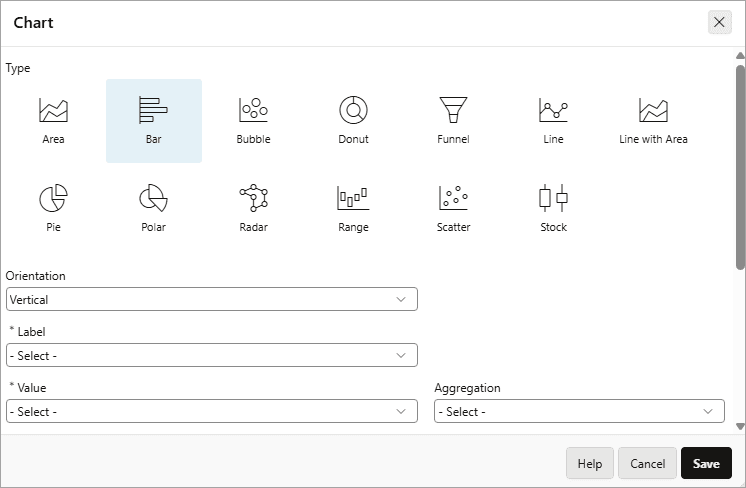

  1. Click the Actions menu and select Chart.
    The Chart dialog appears.
  2. Select a chart type.
    The dialog populates with options specific to the selected chart type. For example, a bar chart has a different set of configuration fields than a pie chart. Select different types to see the range of available options.
  3. Configure the chart settings.
    For example, the following is a configuration for a Bar chart:
    • Orientation - Select Vertical for the bars to increase toward the top of the chart, or Horizontal to increase toward the right.
    • Label - Select the column to be used as the Label (the label appears beneath or beside the bar).
    • Value - Select the column to be used as the Value (the value is the quantity that determines the size of the bar).
    • Aggregation - (Optional) Select an additional aggregation to be performed on the column selected for the Value. Valid selections include: Count, Count Distinct, Approx. Count Distinct, Minimum, Maximum, Sum, or Average.
  4. Click Save.

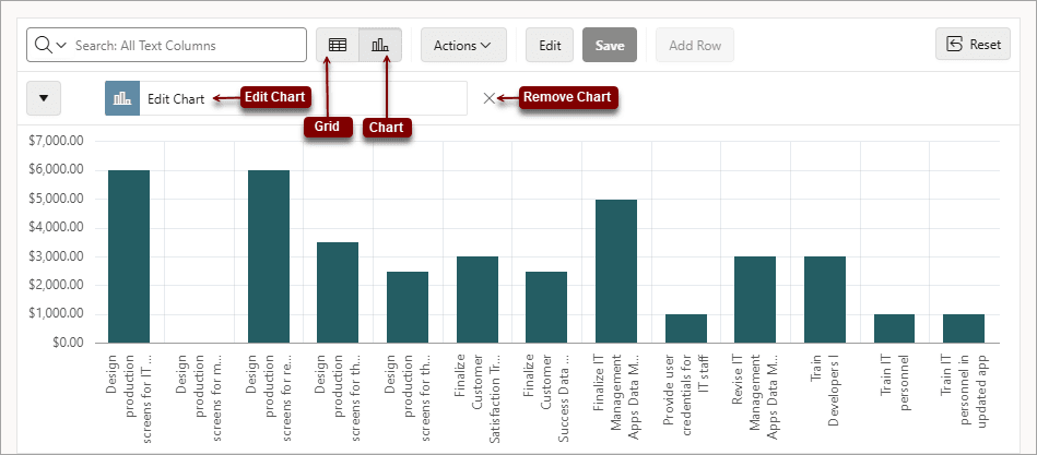

The chart appears. The following is an example of a bar chart that depicts project budgets with a sum aggregation. To switch the view between Grid and Chart, click the toggle that now appears at the top of the interactive grid.
To reconfigure the chart, click the Edit Chart link.
To remove a chart, click the Remove Chart icon (X) adjacent to the chart link.
You can only create one chart at a time in an interactive grid. To create a second chart, reconfigure the existing chart by clicking Edit Chart, or delete it by clicking the adjacent Remove Chart icon (X).
