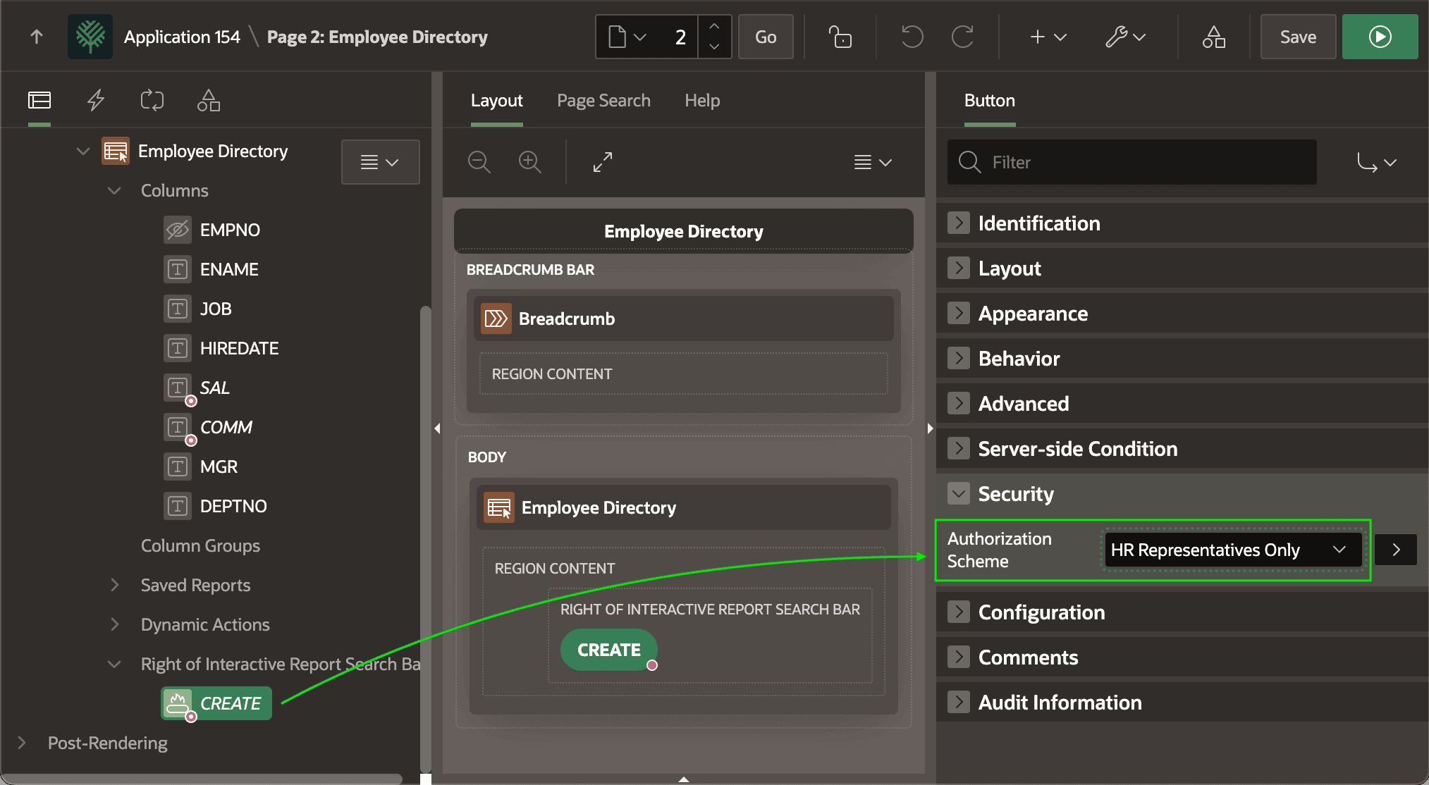

Configure a button’s Authorization Scheme to control which users can see it.
As shown below, in the Employee Directory page, you set the CREATE button’s Authorization Scheme to HR Representatives Only. This lets HR Reps see this button to create a new employee. In contrast, any other users viewing the directory do not see the button at all, so they can’t create employees.
If the button submits the page to trigger a page process, you can apply the same authorization scheme to the corresponding page process as an additional access check.
Tip: The Employee page the CREATE button targets also has a page-level authorization scheme of HR Representatives Only. So, any manual attempt by unauthorized users to visit that page results in an error.
Applying Authorization Scheme to a Button
