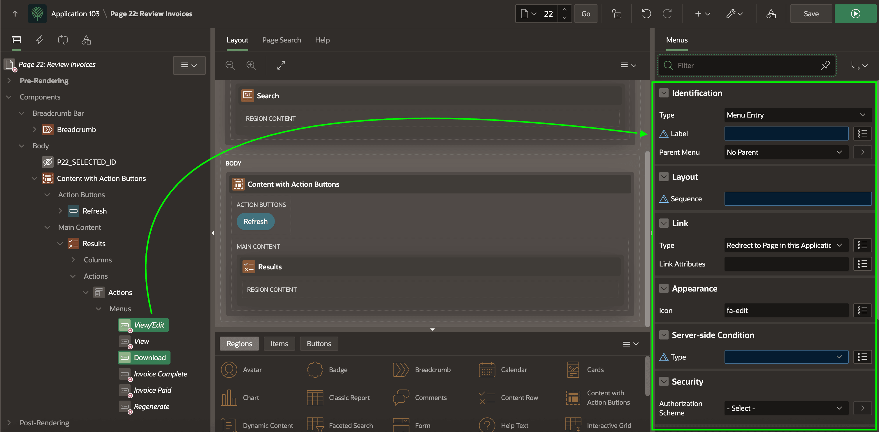

Configuring Settings for Multiple Components
When you select multiple components in the Rendering, Dynamic Actions, or Processing tabs, the Property Editor shows the settings in common to all selected components. To perform multiple selection, you can:
As shown below, when the selected components have the same value for a common setting, like Icon, the property value displays. When their values for a property differ, a delta symbol appears and the property shows empty.
Setting any property value while multiple components are selected sets that same value on all selected components.
Working with Properties of Multiple Selected Components

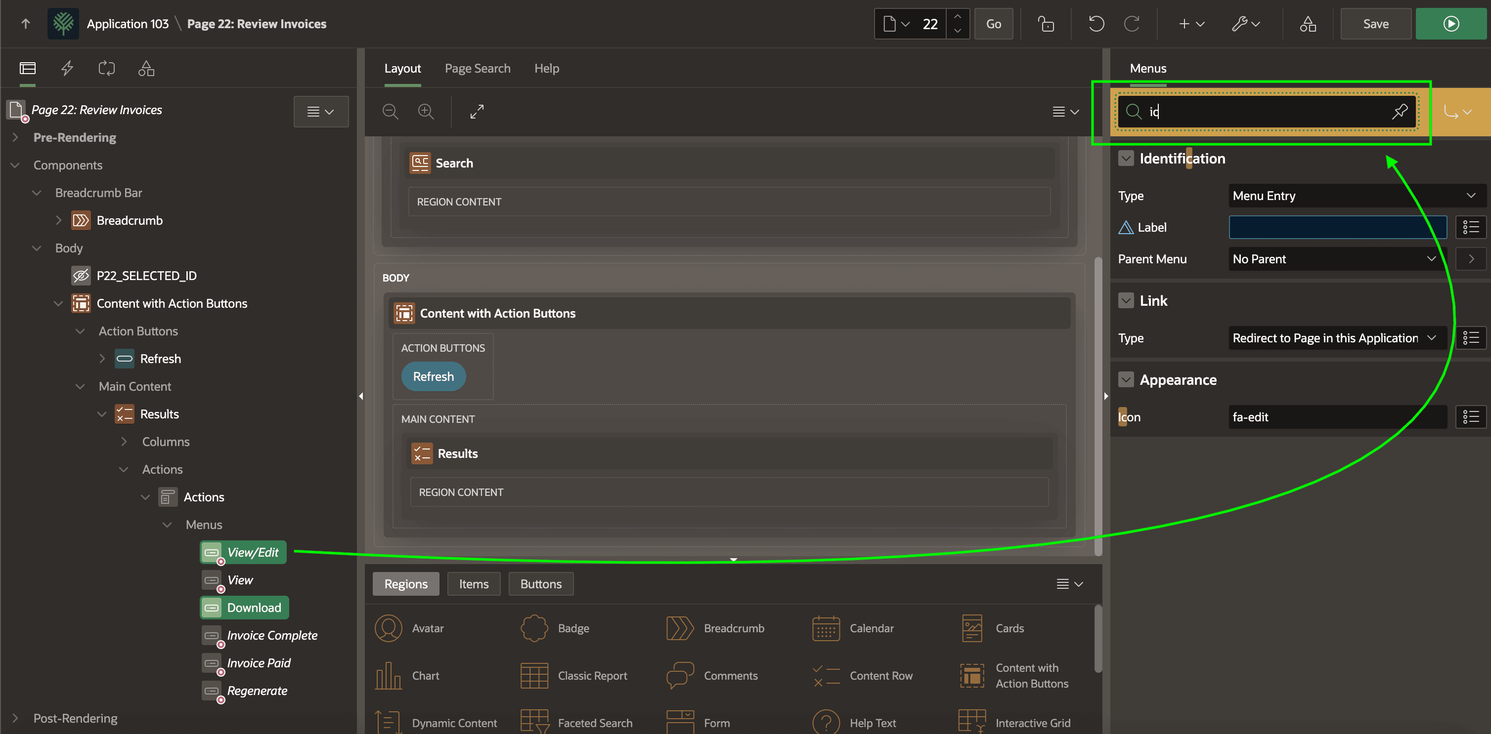

Use the Filter search field at the top of the Property Editor to find a particular setting by name. As shown below, after typing ic into the field, the editor displays a filtered view of properties whose section title or property name contains the search term. Search results include the Identification group and the Icon setting, both of which contain ic in their name. This property search helps you quickly narrow the focus to just the property you need to change. Press the Escape key while the search field has focus to clear the search and see all settings again.

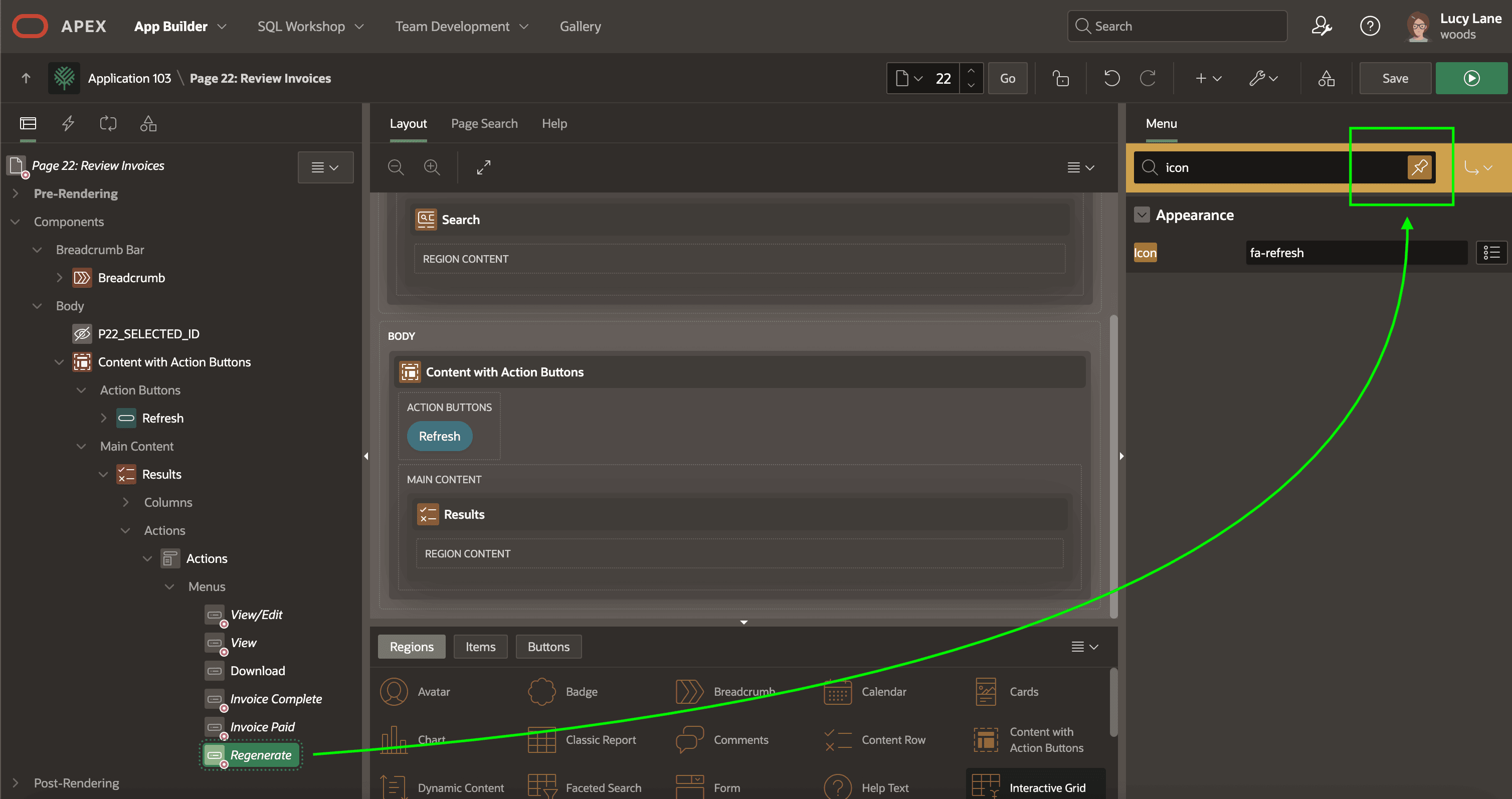

If you plan to inspect or change a particular property across multiple components, select them all, search in the Property Editor to find the setting, and then set their common property in one go. As shown below, you can also search the Property Editor first to find the setting and then click Pin in the search field. This “freezes” the search until you click Pin again to unpin the search. With the search pinned, you can visit any number of components in the page and see or change only the properties in the filtered Property Editor.
