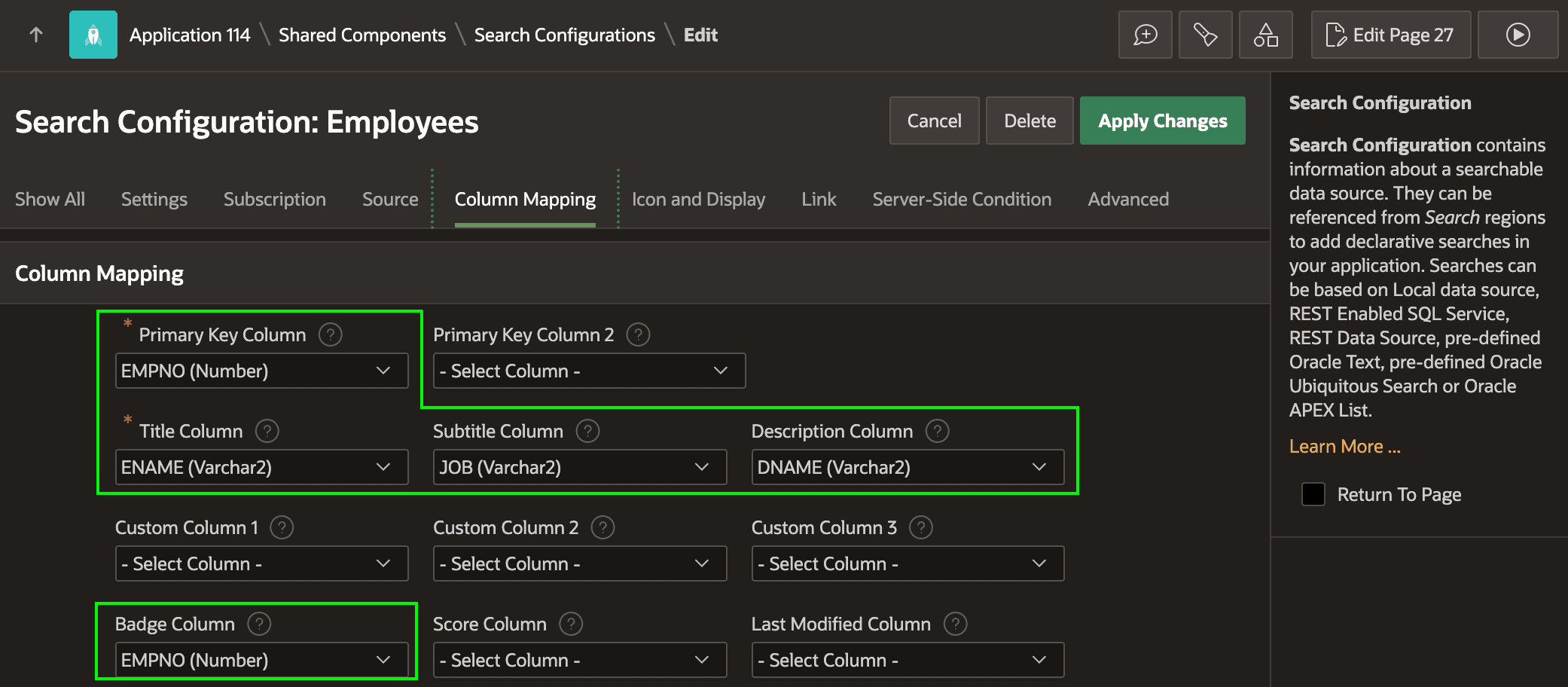

As shown below, it maps EMPNO as primary key, ENAME as the title, JOB as subtitle, DNAME as description, and shows a badge using the EMPNO column value.

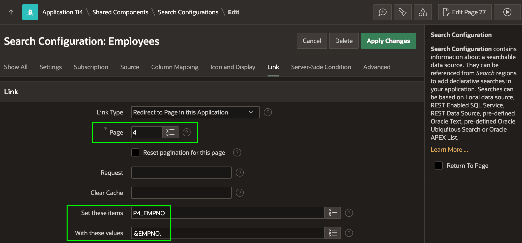

After configuring that the search result icon name comes from the ICON column on the Icon and Display tab, you define the link information. As shown below, when the user clicks on a search result from this Employees search source, they should navigate to a modal Employee edit page number 4, passing the value of the result’s EMPNO column as the P4_EMPNO parameter. The figure shows the Link section of the Search Configuration edit page where your set up these options.
