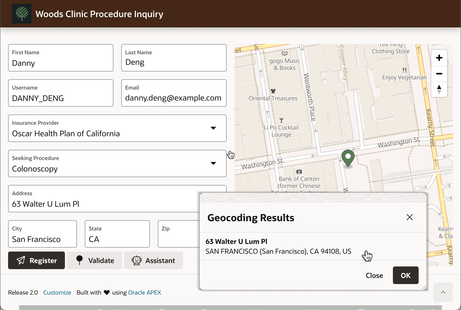

As shown below, a Geocoded Address page item in the registration page identifies the longitude and latitude of a new patient’s home address. The page saves these coordinates along with the patient’s other data in the FRC_PATIENTS table.
Geocoding New Patient Address in Registration Page

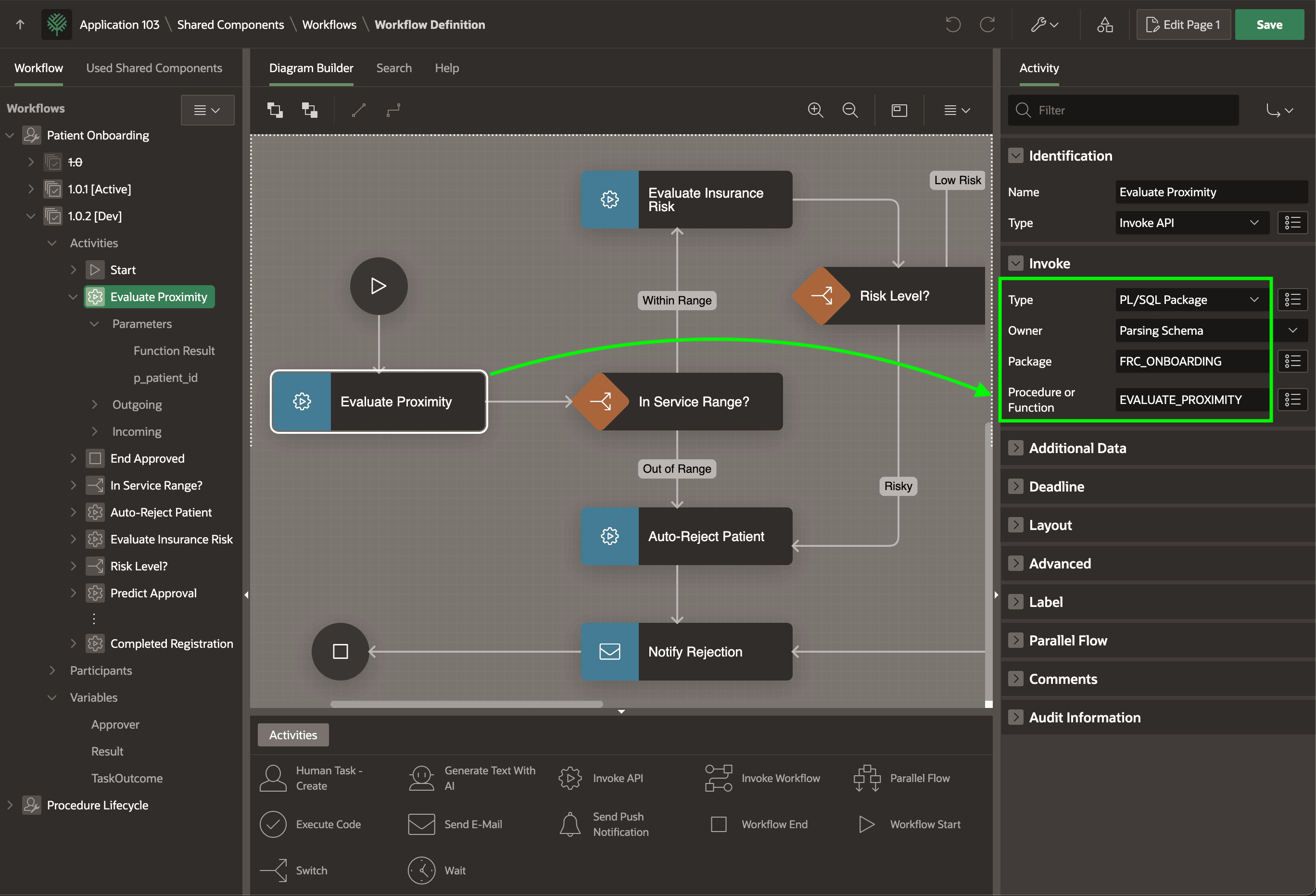

The Evaluate Proximity activity shown below is an Invoke API that calls the EVALUATE_PROXIMITY PL/SQL package API to determine if the patient’s home address is within the clinic’s 400km service radius.
Invoking a PL/SQL Package API to Evaluate Service Range

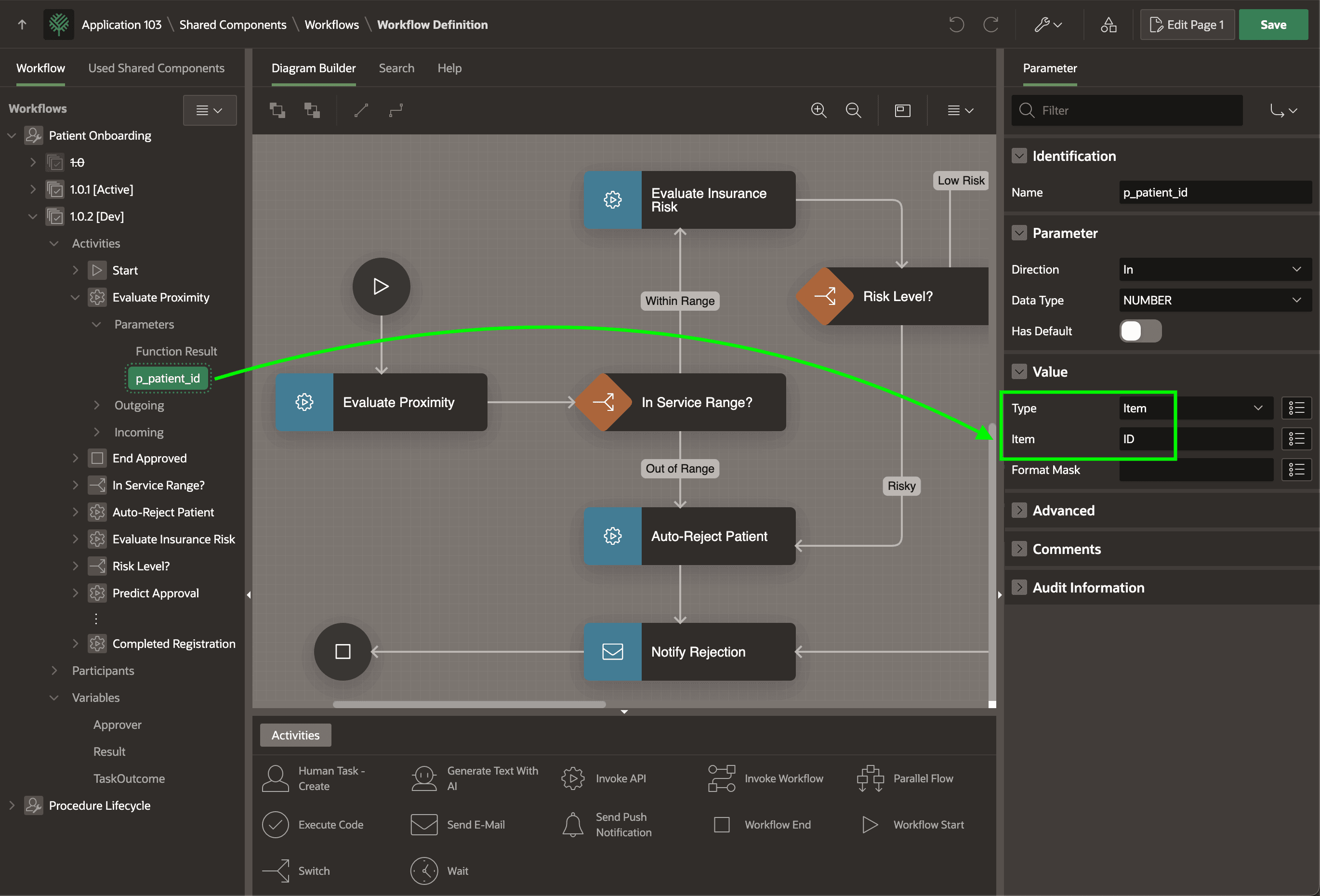

The function accepts a patient ID and returns an outcome string of “Within Range” or “Out of Range” that the following In Service Range? switch activity uses to decide which way to flow. As shown below, you configure the invoked function’s parameters using the Property Editor after selecting each parameter name under the activity’s Parameters heading in the Workflows tree. Here, the P_PATIENT_ID parameter’s value comes from the workflow Additional Data column ID containing the patient identifier associated to the current workflow instance. The Function Result is mapped to the V_RESULT workflow variable whose Result label shows under the Variables heading in the tree.
Configuring Patient ID as Value of P_PATIENT_ID PL/SQL Parameter
