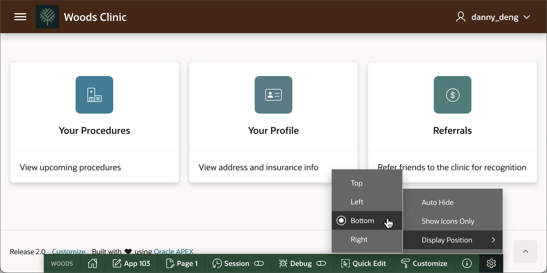

During development, when you run your app from App Builder, it’s in “Development Mode”. The Developer Toolbar appears when in this mode. Using its settings menu, as shown below, you can change its default display position, auto-hide behavior, and button display style.
Development Toolbar Appears When Running in Development Mode

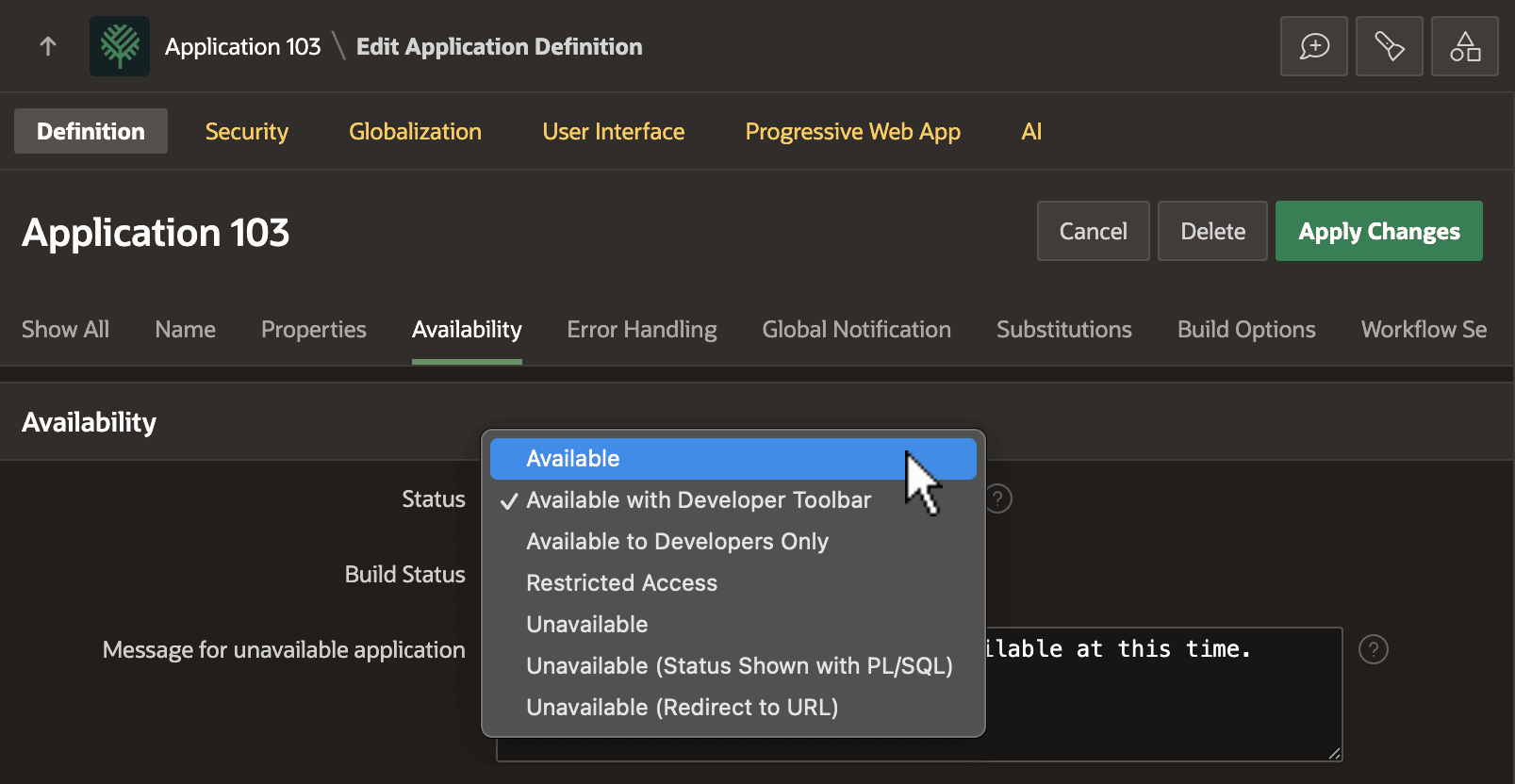

You can disable the Developer Toolbar in Development Mode session if necessary. As shown below, change the Availability > Status setting in Shared Components > Application Definition to Available instead of the default Available with Developer Toolbar.
Your Availability Setting Can Disable the Developer Toolbar
Tip: Check your app’s Availability > Status setting if you don’t see the Developer Toolbar when running from App Builder, but do want it to display. Make sure it’s set to Available with Developer Toolbar.
