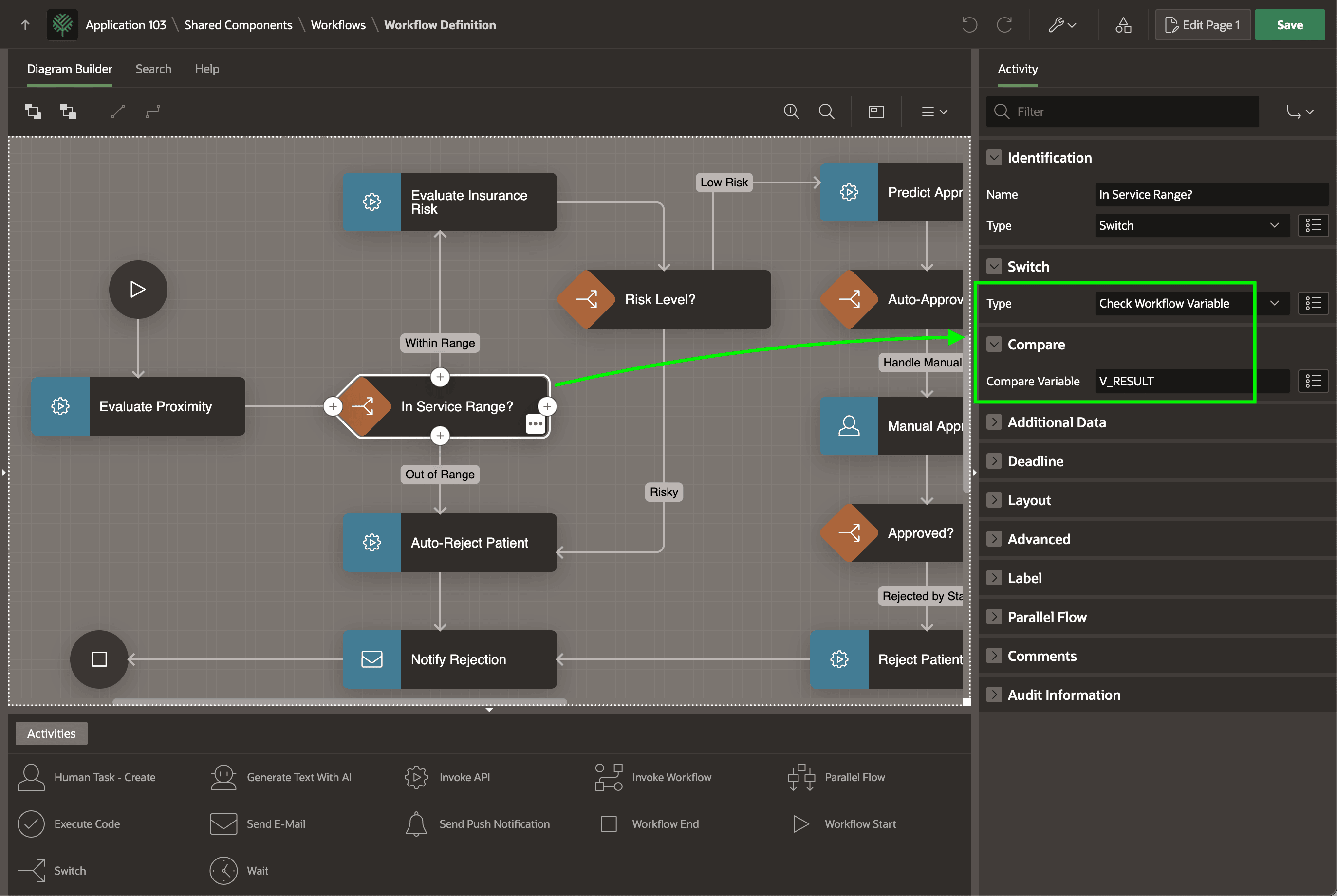

The Evaluate Proximity activity configures the V_RESULT workflow variable to store its Function Return value. The subsequent In Service Range? is a Switch activity that as shown below is set to check this V_RESULT variable to decide which path to follow. The Switch activity identifies the source of the conditional decision. Then, each connection originating from that Switch activity configures a condition based on this source. When evaluating the next activity, the APEX engine follows the connection path whose condition evaluates to true.
Configuring a Switch Activity to Decide Based on a Workflow Variable

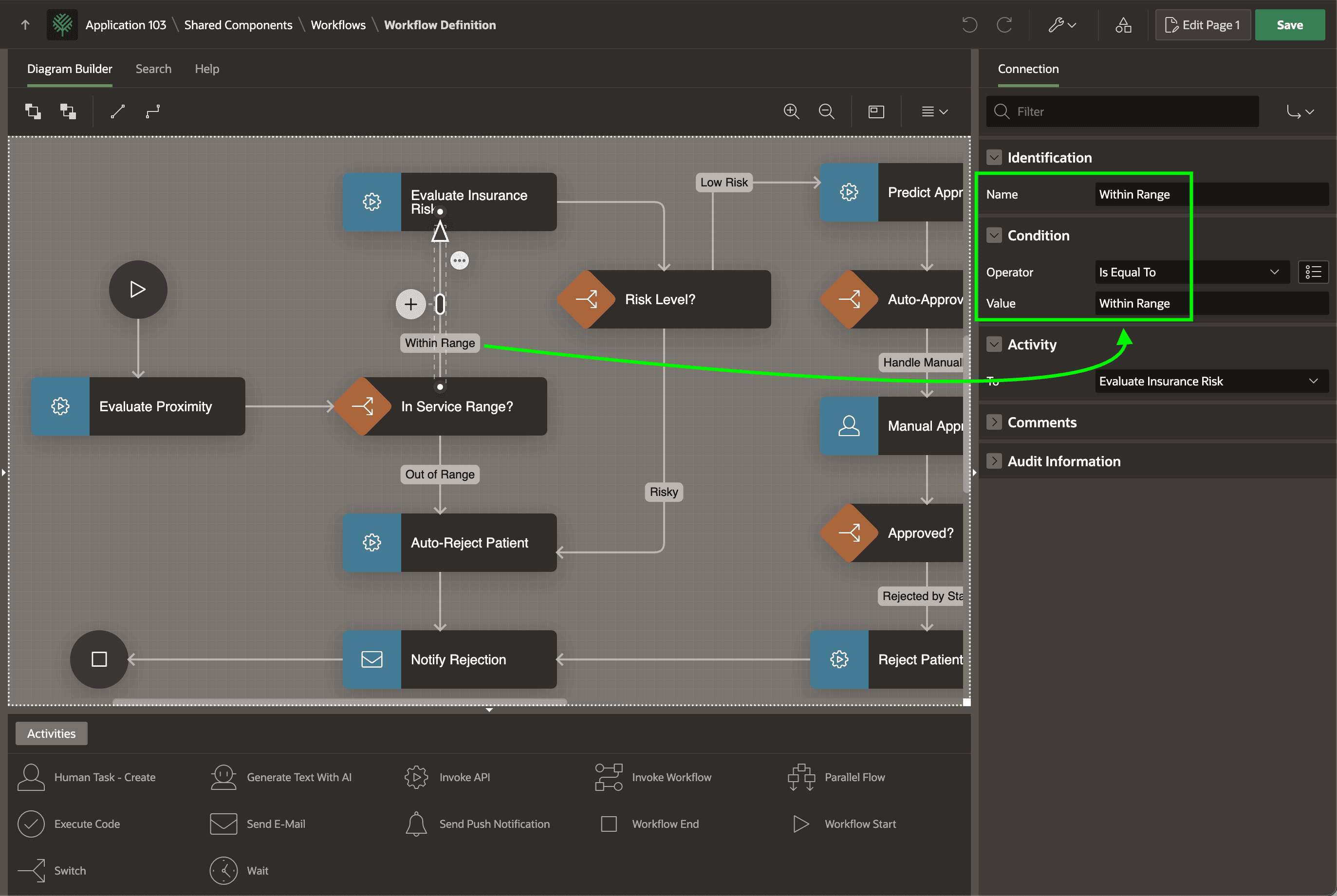

As shown below, the connection named Within Range represents the condition that the Switch source V_RESULT equals the literal value “Within Range”. The name of the connection need not coincide with the condition value, but sometimes that makes the diagram the most easy to understand. For example, you could change the connection name to Inside Service Area, as long as the condition remains the same, without affecting the workflow’s flow.
Assigning Outcome Condition to Connection Originating from a Switch
