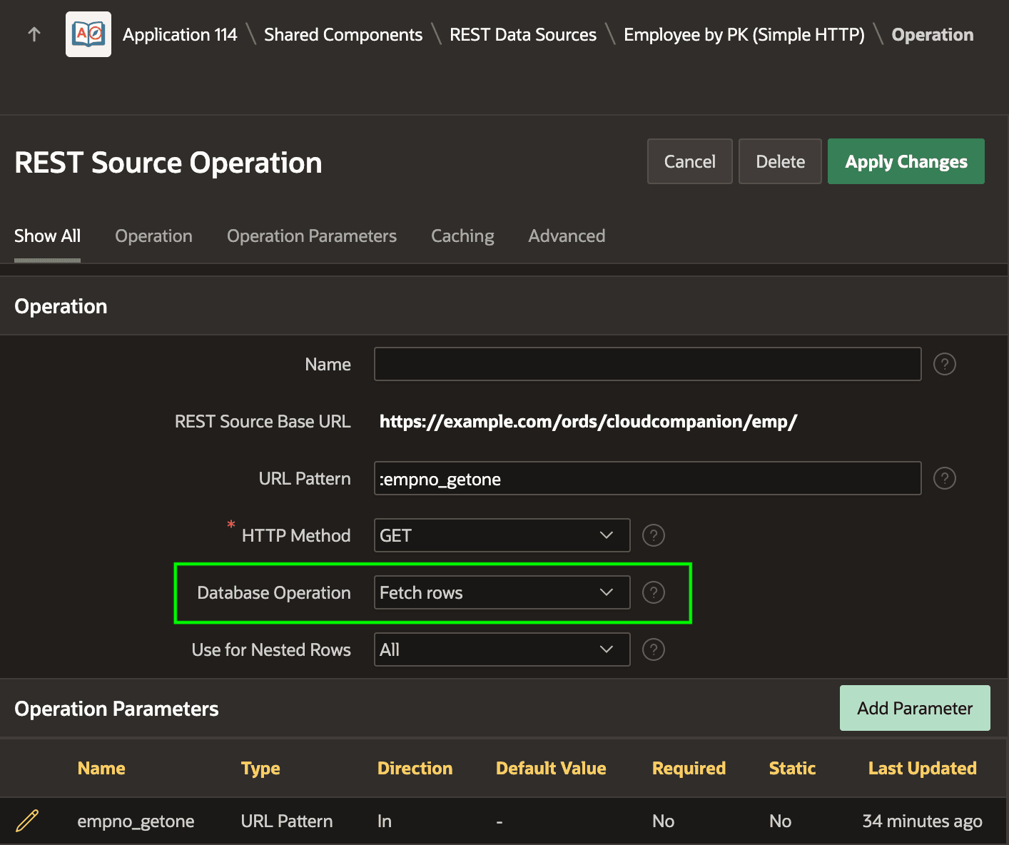

The Employee by PK (Simple HTTP) REST Data Source, with Static ID employee_by_pk_simple_http has just a single GET operation with Database Action of Fetch rows. As shown below, it’s configured to use the URL Pattern parameter empno_getone in the URL to retrieve a single employee.
Fetch Rows GET Operation to Retrieve One Employee by PK
At runtime, by setting the empno_getone parameter to a value like 7788 as the example above is doing, if debug tracing is enabled you would see the APEX engine requests the URL:
making GET request to https://example.com/ords/cloudcompanion/emp/7788

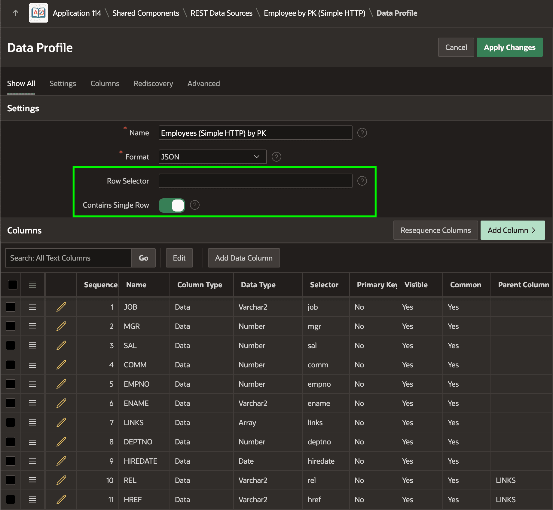

This means the Employee by PK (Simple HTTP) REST Data Source needs a Data Profile that caters for this different, single-row response. As shown below, the Data Profile for this REST Data Source omits the Row Selector and enables the Contains Single Row switch.
Data Profile for Employee by PK (Simple HTTP) REST Data Source
