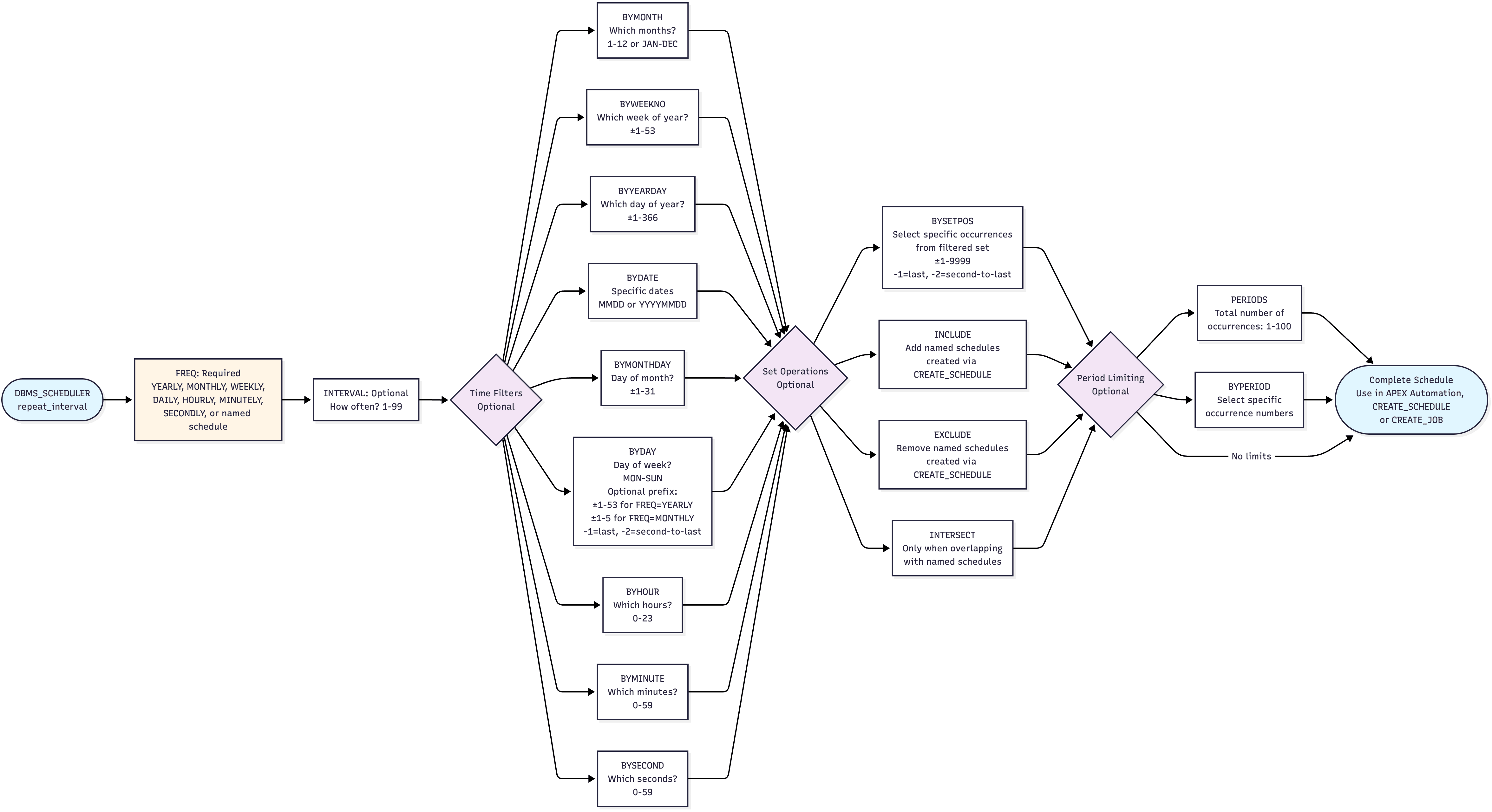

The automation’s Schedule Expression supports any Database Scheduler syntax. These are the same ones the DBMS_SCHEDULER package accepts to create named schedules and create scheduled jobs. The diagram below summarizes the options you can use. You specify an expression using semicolon-separated list of one or more KEYWORD=VALUE elements. Supported keywords include:
FREQ– Frequency of repetition (required) -
INTERVAL– Repetition counter (n= repeat everynth frequency unit) -
<Time Filter> – Identifies specific time elements to fine-tune exactly when it repeats
<Set Operations> – Combine with a named schedule, or pick occurrences within a cycle
<Period Limiting> – Limit the total number of cycles, or pick specific cycle occurrences.
