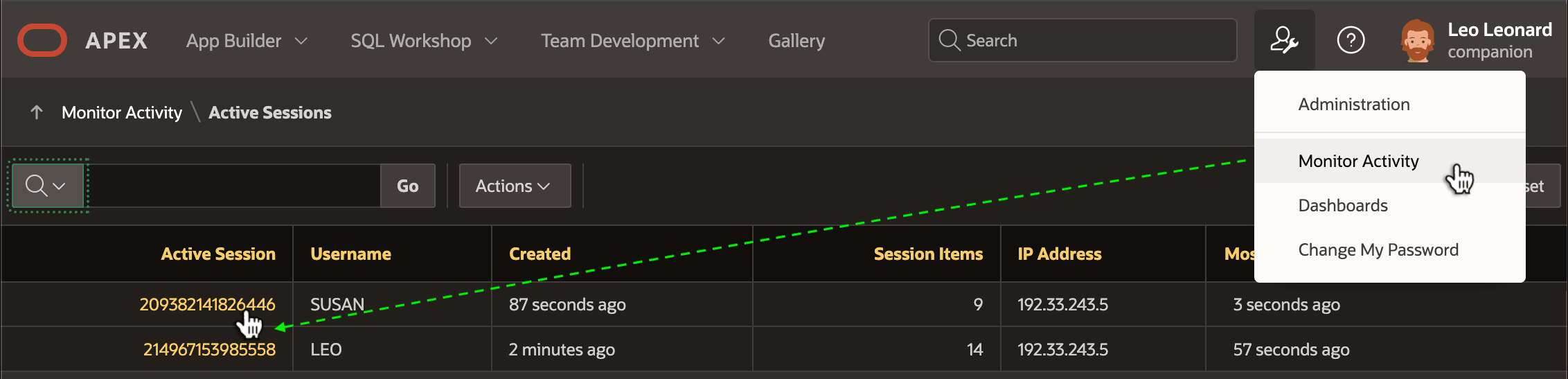

To view the session state of a background process, start by opening the Monitor Activity page from the “person with wrench” menu button in the App Builder as shown below. Then identify a user session like SUSAN’s and click its session id link to drill down for more information.
Drilling Down into an Active Session for a User

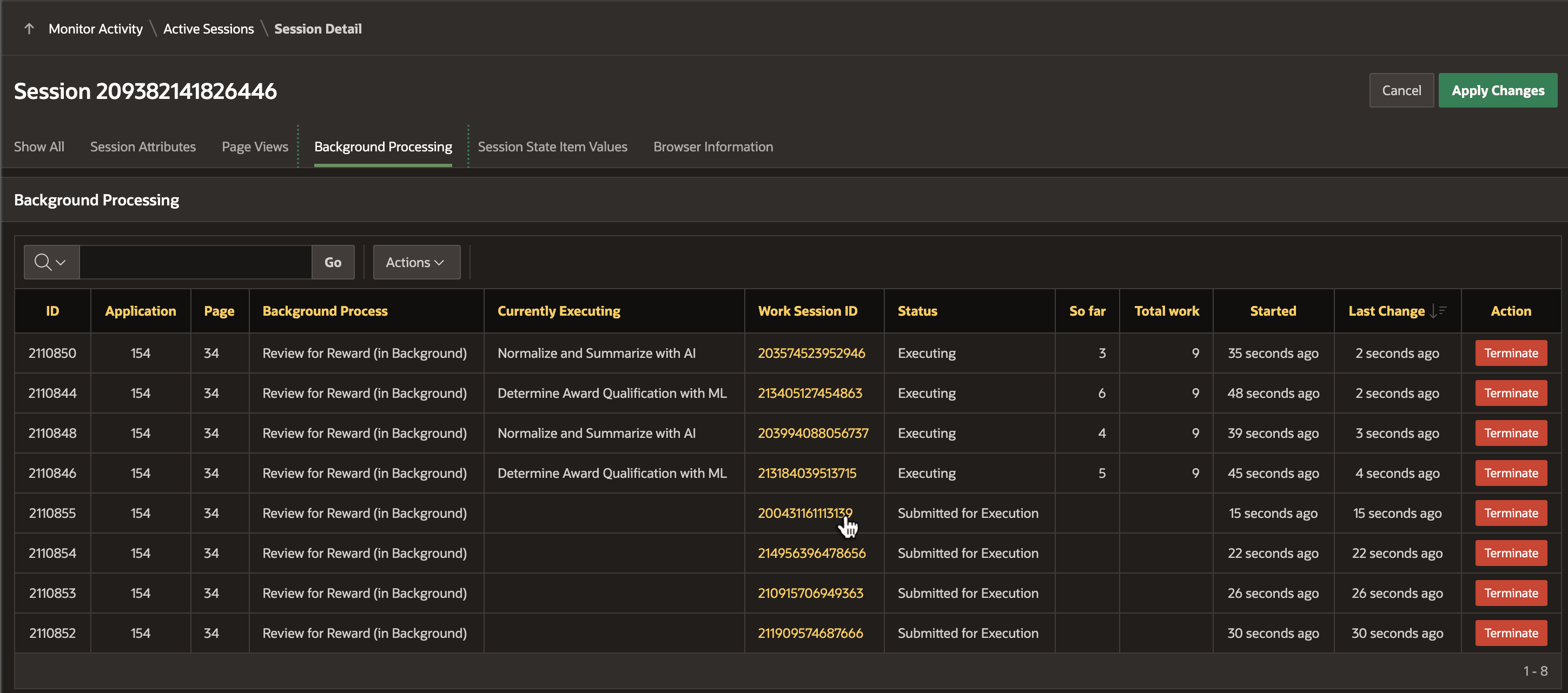

On the Session Detail page, select the Background Processing tab as shown below to see all its scheduled and running jobs. To view the session state of a particular background job’s session, just click on the appropriate session id link in the Work Session ID column.
Reviewing Background Executions for Specific User Session

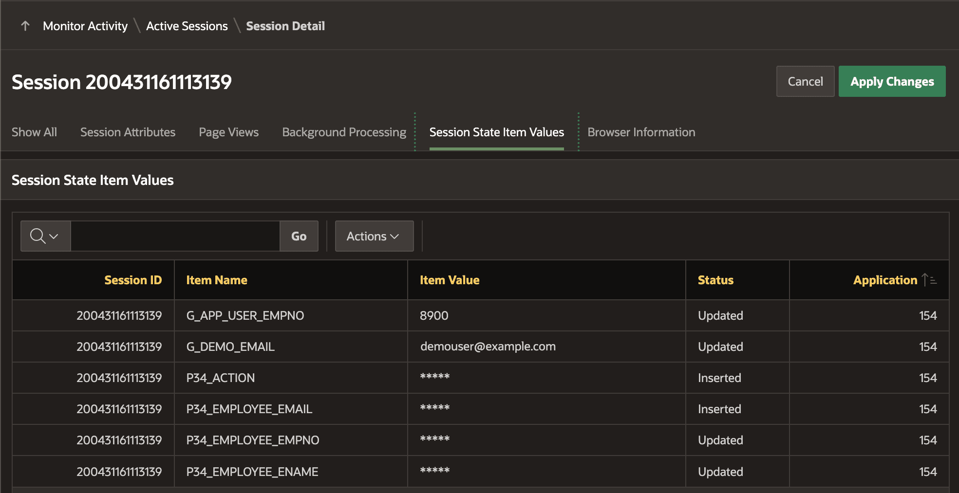

This opens the Session Detail page for the background job’s working session. From there, select the Session State Item Values tab. As shown below, you can then inspect the values of any session state that are not encrypted.

Viewing Session State for a Background Process Work Session
