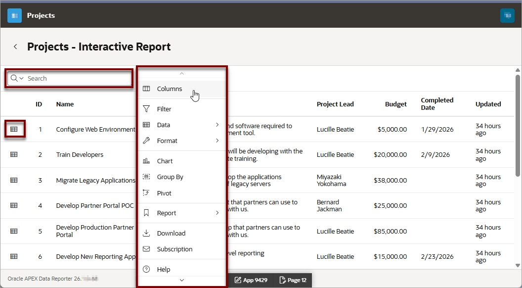

Example Interactive Report
View an interactive report based on the EBA_PROJECTS table.
Users can customize how and what data displays. By default, interactive reports include a search bar, an Actions menu ( Interactive report Actions menu ), column heading menus, and a View Row Detail icon in the first column of each row. Using options on the Actions menu, users can alter the report layout by hiding or exposing specific columns and applying filters and alter the format by creating control breaks, adding highlighting, and determing the number of rows that display on each page. They can also create aggregations, charts, group bys, and add their own computations. Once customized, the report can be saved as either a private or public report.

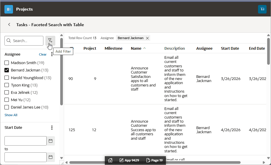

Example Faceted Search with Table
View a faceted search with table based on the EBA_PROJECT_TASKS table.
The following example features a faceted Search region and report. The Search region displays on the left side of the page and enables users to narrow down the search result by selecting facet values. Narrowing the search result, makes it easier for users to find the data they want. The right side of the page features a Search Results region which can display as a classic report.
This example is built on the EBA_PROJECT_TASKS table. In this example the Assignee, Bernard Jackman, is selected and the report displays 13 rows. The cursor is positioned over the Add Filter. Selecting Add Filter displays Add Filter dialog.

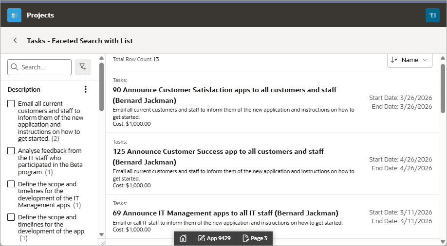

Example Faceted Search with List
View a faceted search with list based on the EBA_PROJECT_TASKS table.
The following example features a faceted Search region and list. The Search region displays on the left side of the page and enables users to narrow down the search result by selecting facet values. Narrowing the search result, makes it easier for users to find the data they want. The right side of the page features a Search Results region displayed as a list.
This example is built on the EBA_PROJECT_TASKS table. In this example, the total row count is 13.

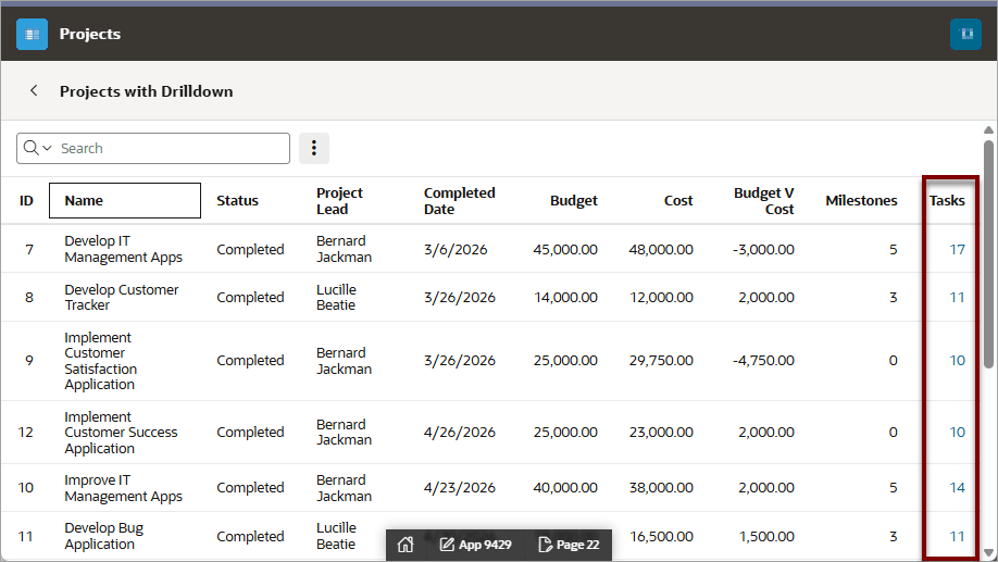

Example Drill Down
View a faceted search with list from an interactive report using a Drill Down.
You can use Drill Down functionality to connect two reports together. The following example shows an interactive report built on EBA_PROJECTS_V. The Tasks column features a drilldown links to another report.

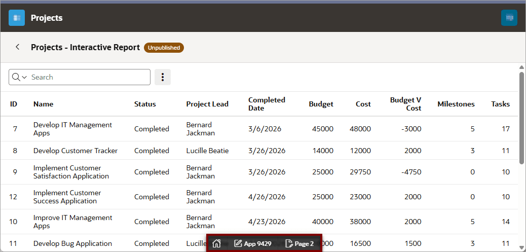

About the Data Reporter Developer Toolbar
Learn about the Data Reporter Developer toolbar.
When you run a reporting application and preview a report, the Data Reporter Developer toolbar appears. The Data Reporter Developer toolbar contains tools for editing the reporting application or the current report page.
The Data Reporter Developer toolbar contains three controls:

      • Facet Label - The display label for the facet.
      • Facet Sequence - The sequence for the facet.
      • Facet Type - Select the facet type.
      • Facet Display - Select Inline or Add Filter Dialog. For more information, see item-level help.
    • Sort Configuration:
      • Enable Sorting - Select whether to allow the column to be sortable in the report at runtime.
      • Sort Label - The display label for the sort.
      • Direction - The default direction for the Order By clause.
      • Null Sorting - The default position for NULL values.
      • Sort Sequence - The sequence for the sort.

Adding a Drilldown
Add a drilldown by editing a report to link to another report.
  1. From the Data Reporter Home page, select the reporting application.
  2. Select a report to contain a drilldown.
  3. Under Facets and Columns, select Edit:
    1. Enable Drill Down - Select to use the column values to drill down into another report. The drilldown report is filtered by the selected column value.
    2. Target Report - The target report the column navigates to.
    3. Target Column - The column from the target report to filter by.
    4. Source Column - The column in this report to pass as the filter value.
  4. Select Apply Changes.
  5. To view the report, select Run.
