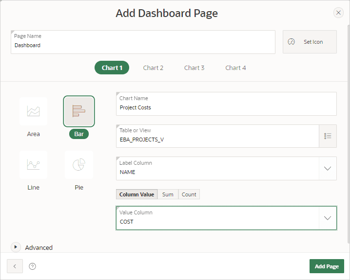

  9. Create Chart 1:
    1. Chart Type - Select Area, Bar, Line, or Pie.
    2. Chart Name - Enter the name for the chart.
    3. Table or View - Click the LOV icon (bullet points and lines) and select a table or view on which to build the chart.
    4. Label Column - Select the column from the table or view to use as the label for the chart.
    5. Value Aggregation - Select how to aggregate the chart Value Column (Column Value, Sum, or Count.
      For example, selecting Count bases the aggregation on the selected Label Column. For all other aggregation types, if no Value Column is selected, the aggregation is based on the select Label Column.
    6. Value Column - Select the column name to be used for defining the value on this chart.
