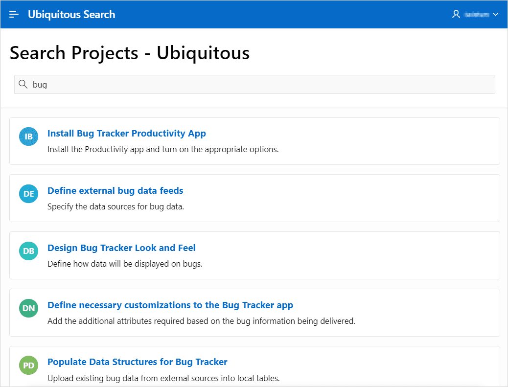

  8. Run and test the page:
    1. Click Save and Run Page.
      The search page appears.
    2. In the search field, enter a search (for example, bug) and press Enter.
    The search results appear.
