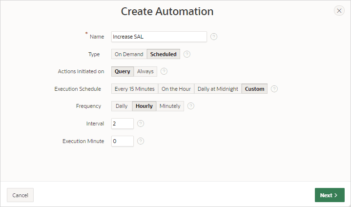

  4. Specify the automation name and define the execution schedule:
    1. Name - Enter a name for the new Automation. For example, Increase SAL.
    2. Type - Select an automation type. Select Scheduled.
      Scheduled executes automatically based on the selected frequency. On Demand executes when called explicitly using the APEX_AUTOMATION package.
    3. Actions initiated on - Select Query.
      This option determines whether the execution of Automation Actions should be initiated based on a Query (that is, the rows returned can then be used by the actions), or if the actions should Always be executed.
    4. Execution Schedule - Select an execution schedule for the new automation. Select Custom.
      The Frequency, Interval, Execution Minute attributes only display if Execution Schedule is set to Custom.
    5. Frequency - Specify whether the execution schedule should be based on a daily, hourly or minutely basis. Select Hourly.
    6. Interval - Enter 2 so that automation executes every 2 hours.
    7. Execution Minute - Specify the execution minute, from 0 to 59. Leave this to the default, 0.
      The Create Automation Wizard should resemble the following illustration.

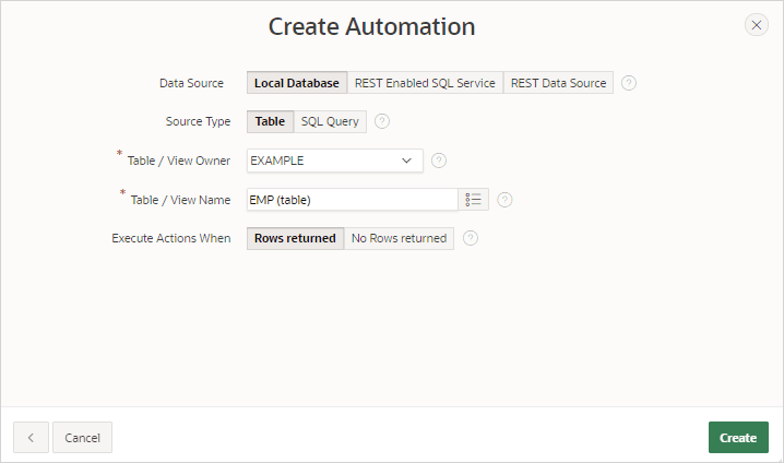

  5. Define the source:
    This example is based on the local table, EMP.
    1. Data Source - Select the data source for this automation. Select Local Database.
    2. Source Type - Select Table.
    3. Table/View Owner - Select the owner of the table on which you are basing this automation.
    4. Table/View Name - Select the table or view on which the automation will be based. For this example, select EMP (table).
    5. Execute Actions When - This option determines if Automation Actions should execute when the query returns rows, or when the query does not return rows. Select Rows returned.

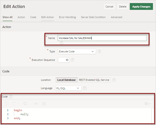

  6. Edit the action for the first salary increase:
    1. Scroll down to Actions.
      Note that the wizard created an action, named New Action.
    2. Edit the new action, New Action:
      • Click the Edit icon adjacent to New Action.
        The Edit Action page appears.
      • Name - Enter a meaningful name such as Increase SAL for SALESMAN.
        The Edit Action page should resemble the following illustration.
      • Code - Add code for the first salary (SAL) increase.
        begin
        update emp set sal = round(sal * 1.015, 1) where empno = :EMPNO;
        apex_automation.log_info('SAL for ' || :ENAME || ' increased.');
        end;
        Note that the code will run on each row. In this example, each SQL UPDATE statement works on a single row based on the EMPNO primary key column. Also note the use of the APEX_AUTOMATION.LOG_INFO procedure . The LOG_INFO procedure writes a message with the “Information” level to the Execution Log for the automation. Available message levels as “Information” are “Warning” and “Error”.
