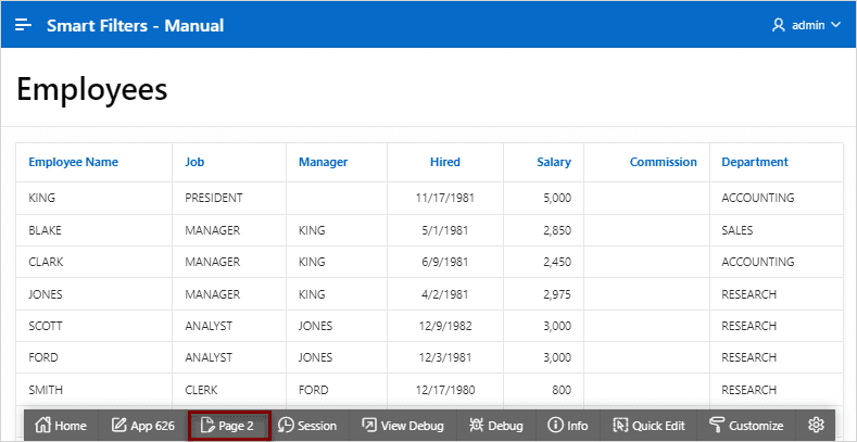

  3. View the new page.
    1. On the Application home page, select the new page, 2 - Employees.
      The page displays in Page Designer.
    2. Click Save and Run Page on the right side of the Page Designer toolbar.
    3. When prompted, enter your workspace username and password and click Sign In.
      A Employees report appears.
    4. Return to Page Designer. Click Page X on the Developer toolbar where X is the page number.

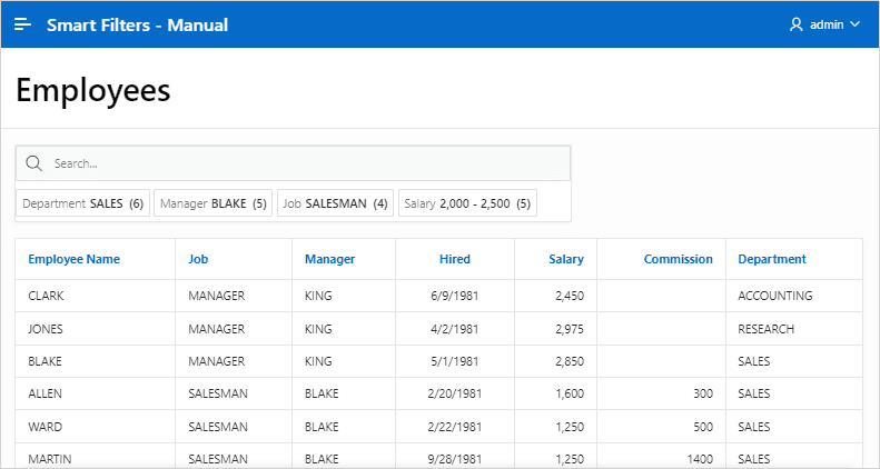

  11. View the page.
    1. Click Save and Run Page in the upper right corner.
    2. If prompted, enter your workspace username and password and click Sign In.
      The revised page appears. Notice four suggestion chips display under the search field.
    3. Test the page. Select filters. To remove a filter, click the X after the filter name.
