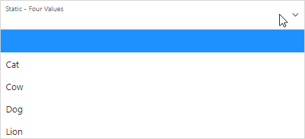

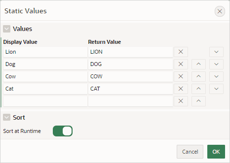

Example 13-1 Four Values Displayed in Alphabetical Order
This example shows the Static Values dialog with four values defined: Lion, Dog, Cow, and Cat. The return value of each entry is capitalized.Sort at Runtime is set to On so that the list displays alphabetical order.
In a running application this select list would look similar to the following illustration.

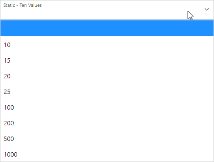

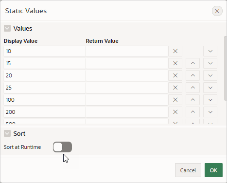

Example 13-2 Values Displayed in the Order Listed
This example shows the Static Values dialog with ten values defined: 10, 15, 20, 25, 50, 100, 200, 500, 1000, and 10000 which display in the order listed. The return value of each entry equals the display value.

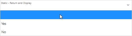

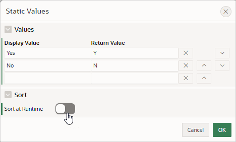

Example 13-3 A List of Values with Having Both a Return and Display Value
This example shows the Static Values dialog with two values defined. The first value has a Display Value of Yes and a Return Value of Y. The second value has a Display Value of No and a Return Value of N Sort at Runtime is set to Off to make sure Yes always displays first.
