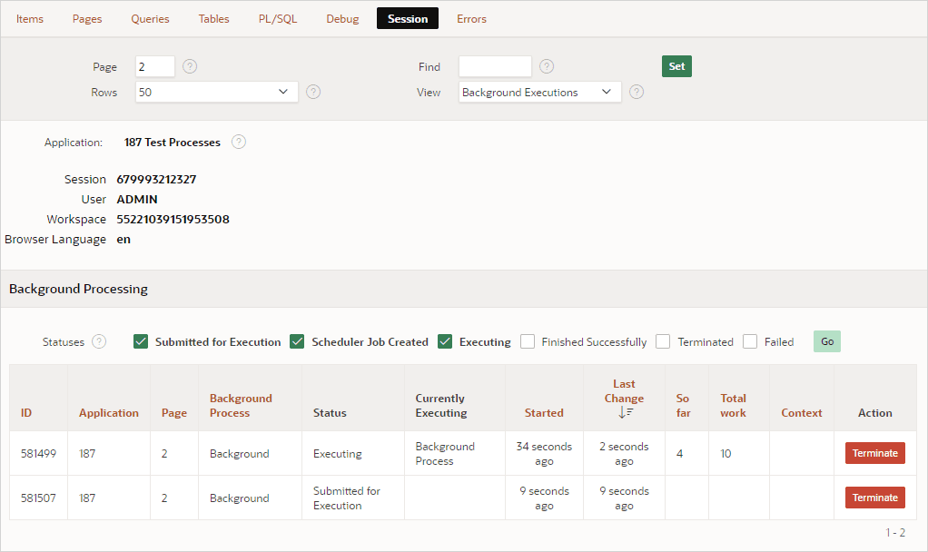

Monitoring Currently Running Background Processes
Monitor background processes by clicking Session on the Developer toolbar.
Tip: You can also view a Background Processing report for Active Sessions in Workspace Administration. From the Administration menu, select Monitor Activity and then Active Sessions. Select an active session and then Background Processing.
To monitor background processes:
  1. Run the application as a developer.
  2. Locate the Developer toolbar. By default, the Developer toolbar displays at the bottom of the page.
  3. On the Developer toolbar, click Session and then View Session State.
    The Session page appears and displays the following information displays at the center of the page.
  4. From View, select Background Executions and click Set.
    The Background Processing region appears displaying currently running background processes as shown in the following example.
  5. Statuses - Configure which background executions to include and click Go. Available Statuses include:
    • Submitted for Execution
    • Scheduler Job Created
    • Executing
    • Finished Successfully
    • Terminate
    • Failed
  6. To terminate a currently running background process, click Terminate.
