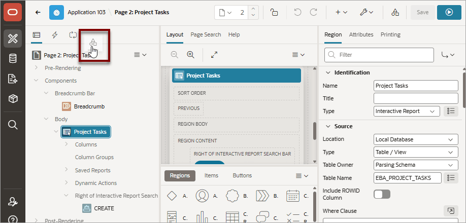

Dragging and Dropping Tabs Between Panes
Drag and drop tabs within a Page Designer pane.
By default, Page Designer displays three panes which contain one or more tabs. You can drag and drop tabs within a pane or between panes by selecting the pane heading (or icon) and then dragging and dropping it to a new location. To return to the default display, click Utilities on the Page Designer toolbar and select Layout and then Reset Layout.
To drag and drop tabs in Page Designer:
  1. View the page in Page Designer:
    1. On the Workspace home page, click the App Builder icon.
    2. Select an application.
    3. Select a page.
    Page Designer appears.
  2. Select a tab heading (or icon) and then drag and drop it to a new location.
    In the following example, the Page Shared Components tab is selected and being moved within the left pane.
  3. To return to the default display:
    1. On the Page Designer toolbar, click Utilities.
    2. Select Layout and then Reset Layout.

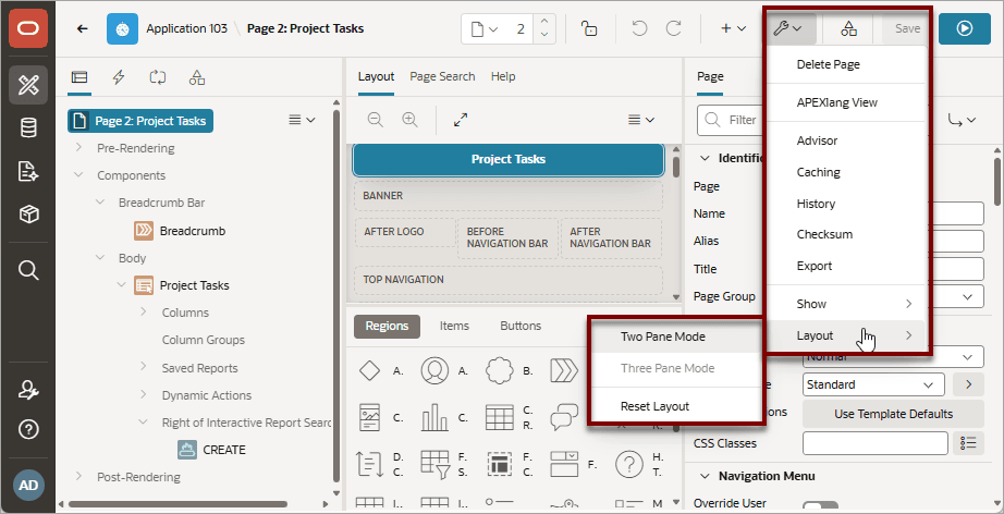

Switching Between Three Pane and Two Pane Mode
Use the Layout options on the Utilities menu on the Page Designer toolbar to switch between pane modes.
Three Pane Mode (the default) displays the left pane, central pane, and the right pane. Two Pane Mode displays just the central pane and the right pane. A typical use case for accessing Two Pane Mode, is when you want to view just the Rendering tree and the Property Editor. To return to the default display, click Utilities on the Page Designer toolbar and then select Layout and then Reset Layout.
To hide and show Page Designer panes:
    3. Select a page.
  2. To select a page mode:
    1. On the Page Designer toolbar, click Utilities and then Layout.
      The Layout menu has three options: Two Pane Mode, Three Pane Mode, and Reset Layout.
    2. From Layout, select one of the following:
      • Two Pane Mode - Displays just the central pane and the right pane.
      • Three Pane Mode (the default) - Displays the left pane, central pane, and the right pane.

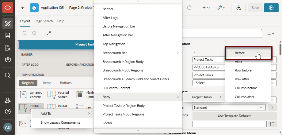

About Adding Components Using Gallery Context Menus
Add a component to a page by right-clicking a component in the Gallery to view a context menu.
In addition to dragging and dropping components from the Gallery, you can also right-click a component in the Gallery to view a context menu. Each context menu features an Add To option which displays the actual locations where you can add the component. In this example, the developer is adding a new report to before the Content Body region.
See Also: Adding a Region, Item, or Button by Dragging and Dropping
