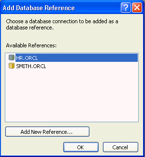

If you right-click on the Database References node in the Oracle Database Project, and select New Database Reference, then the Add Database Reference dialog box launches.
The controls in Oracle Database Project Add Database Reference dialog are as follows:
| Control | Description |
Available References |
Lists connections from Server Explorer which are not included in the Database References node. |
Add New Reference |
Displays the Add Connection Dialog box so that you can create a new database connection. The newly added connection is listed as the last item in the Available References. |
OK |
Adds the selected connection and connection information to the Database References node and updates the project file. |
Cancel |
Closes the dialog. |
