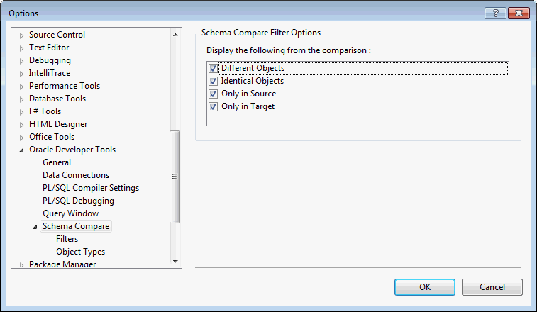

Using the Schema Compare Filter Options Settings
The Schema Compare Filter Options settings appears similar to the following:
Options for Schema Compare Filters
Items selected in the Schema Compare Filter Options page become the defaults for the Schema Compare Source and Target Dialog, Filter Types.
The controls of the Schema Compare Filter Options are as follows:
| Control | Description |
Display the following from the comparison |
Lists the types of results that will be displayed, with check boxes to enable them. |
OK |
Saves and closes the tab. |
Cancel |
Cancels any changes and closes the tab. |

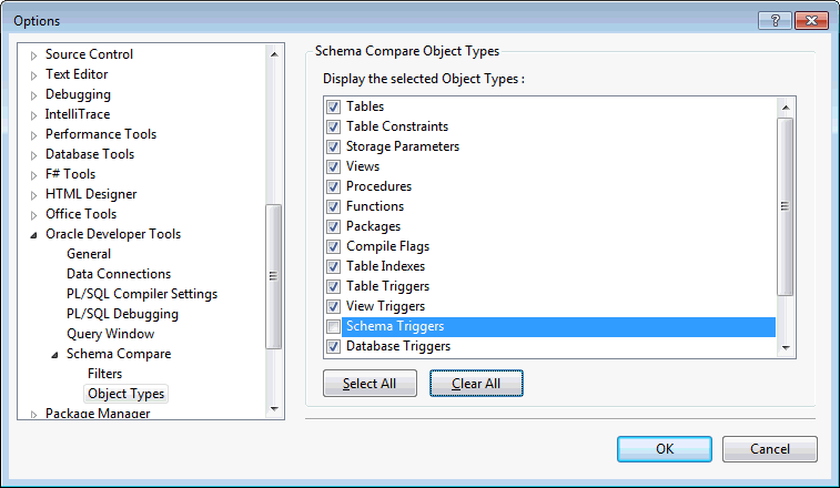

Using the Schema Compare Object Types Options Settings
The Schema Compare Object Types Options appear similar to the following:
Options for Schema Compare Object Types
Items selected in the Schema Compare Object Types Options page become the defaults for the Schema Compare Source and Target Dialog, Object Types.
The controls of the Schema Compare Object Types Options are as follows:
Display the selected Object Types |
Lists the types of objects that will be compared, with check boxes to enable them. |
Select All |
Enables you to select all of the available Object Types. |
Clear All |
Enables you to clear any checked selections. |
OK |
Cancel |
