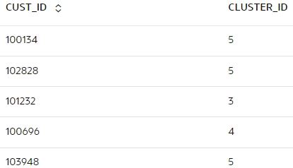

The clusters discovered by k-Means are used to score a new record by estimating the probabilities that the new record belongs to each of the k clusters. The cluster with the highest probability is assigned to the record.
In this step, you will make predictions on the CUSTOMER_DATA_CLEAN and add the CUST_ID as a supplemental column so that you can uniquely associate scores with the data. To do so run the below script:
pred = km_mod3.predict(CUSTOMER_DATA_CLEAN, supplemental_cols = CUSTOMER_DATA_CLEAN[["CUST_ID"]]) z.show(pred)

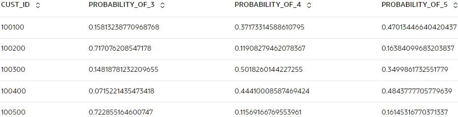

- To make predictions that return probability for each cluster on the
data use predict_proba
function.
pred = km_mod3.predict_proba(CUSTOMER_DATA_CLEAN, supplemental_cols = CUSTOMER_DATA_CLEAN[["CUST_ID"]]) z.show(pred)
