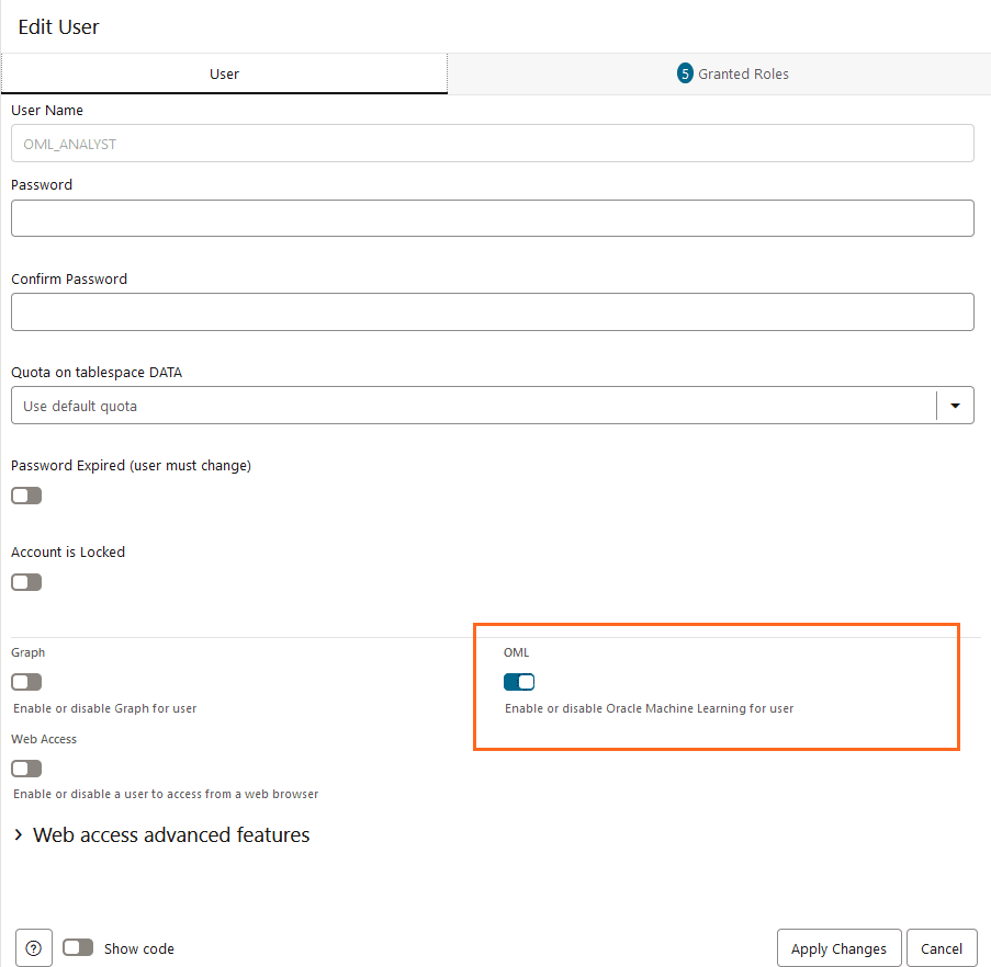

  2. On the Autonomous AI Database Details page, select Database Actions and click Database Users.
  3. In the All Users, search for the user of interest or select the user. For example, search the user OML_ANALYST.
  4. In the user's card, click more actions and select Edit
  5. In the Edit User panel, select OML.
  6. Click Apply Changes.
This grants the required privileges to use the Oracle Machine Learning application. In Oracle Machine Learning this user can then access any tables the user has privileges to access in the database.
