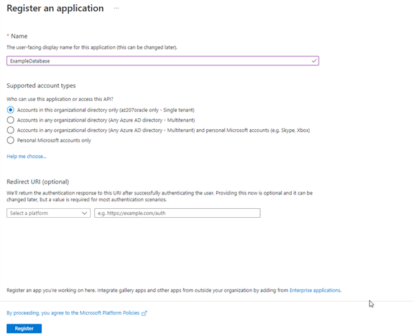

In the Register an application page, enter the following Oracle Database instance registration information:
In the Name field, enter a name for the Oracle Database instance connection (for example,
Example Database). -
Under Supported account types, select the account type that matches your use case.
Accounts in this organizational directory only (tenant_name only - Single tenant)
Accounts in any organizational directory (Any Azure AD directory - Multitenant)
Accounts in any organizational directory (Any Azure AD directory - Multitenant) and personal Microsoft accounts (e.g. Skype, Xbox)
Personal Microsoft accounts only
Bypass the Redirect URI (Optional) settings. You do not need to create a redirect URI because Azure AD does not need one for the database server.
Click Register.
After you click Register, Azure AD displays the app registration’s Overview pane, which will show the Application (client) ID under Essentials. This value is a unique identifier for the application in the Microsoft identity platform. Note the term Application refers to the Oracle Database instance.

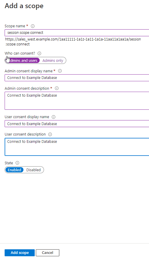

Select Add a scope and then enter the following settings:
Scope name specifies a name for the scope. Enter the following name:
session:scope:connectThis name can be any text. However, a scope name must be provided. You will need to use this scope name later when you give consent to the database client application to access the database.
Who can consent specifies the necessary permissions. Select Admins and users, or for higher restrictions, Admins only.
Admin consent display name describes the scope’s purpose (for example,
Connect to Oracle), which only administrators can see. -
Connect to Example Database), which only administrators can see. -
User consent display name is a short description of the purpose of the scope (for example,
Connect to Example Database), which users can see if you specify Admins and users in Who can consent. -
User consent description is a more detailed description of the purpose of the scope (for example,
State enables or disables the connection. Select Enabled.

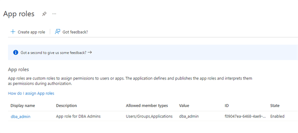

Creating a Microsoft Azure AD App Role
Azure AD users, groups, and applications that need to connect to the database will be assigned to the database app roles.
See the Microsoft Azure article Create and assign a custom role in Azure Active Directory for detailed steps on how to create an app role. The following steps describe how to create the app role for use with an Oracle database.
Log in to Azure AD as an administrator who has privileges for creating app roles.
Access the Oracle Database app registration that you created.
Use the Directory + subscription filter to locate the Azure Active Directory tenant that contains the Oracle Database app registration.
Select Azure Active Directory.
Under Manage, select App registrations, and then select the Oracle Database instance that you registered earlier.
Under Manage, select App roles.
In the App roles page, select Create app role.
In the Create app role page, enter the following information:
Display name is the displayed name of the role (for example,
HR App Schema). You can include spaces in this name. -
Value is the actual name of the role (for example,
HR_APP). Ensure that this setting matches exactly the string that is referenced in the database mapping to a schema or role. Do not include spaces in this name. -
Description provides a description of the purpose of this role.
Do you want to enable this app role? enables you to activate the role.
Click Apply.
The app role appears in the App roles pane.

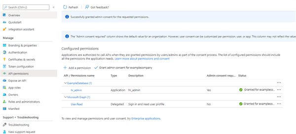

An application that must connect to the database using the client credential flow must to be assigned to an app role.
Log in to Azure AD as an administrator who has privileges for assigning Azure AD users and groups to app roles.
Access the app registration for the application.
Under Manage, select API permissions.
In the Configured permissions area, select + Add a permission.
In the Request API permission pane, select the My APIs tab.
Select the Oracle Database app that you want to give permission for this application to access. Then select the Application permissions option.
Select the database app roles to assign to the application and then click the Add Permission box at the bottom of the screen to assign the app roles and close the dialog box. Ensure that the app roles that you just assigned appear under Configured permissions.
Select Grant admin consent for tenancy to grant consent for the tenancy users, then select Yes in the confirmation dialog box.
